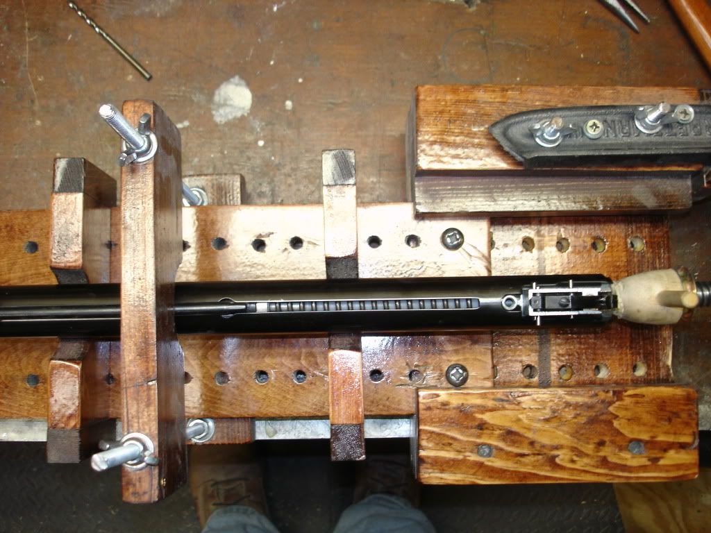

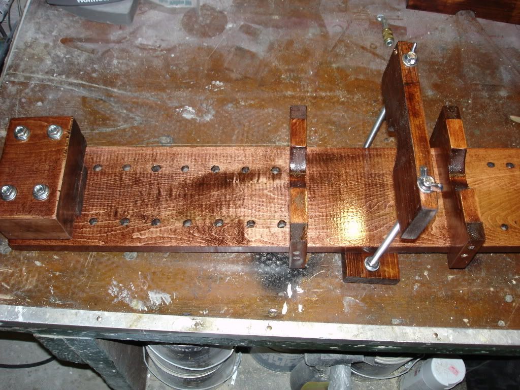

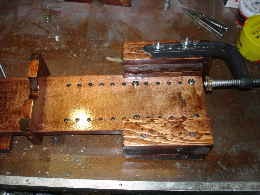

August 21, 2010, 08:18:35 AM »
Here are a few pics of the one I made.
