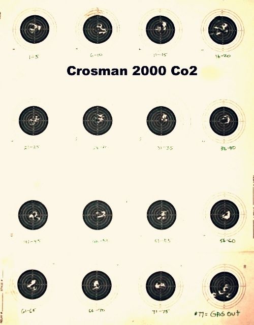

So...I took out the WORST target rifle I own....although I've worked it over quite a bit over the years, it's still running on all stock parts and never had the reputation of shooting great.
Runs on a 12gr. co2, brass barrel soldered to a brass tube, with a 1.2-1.3 pound trigger (which may be too light for some courses of fire). Yep..a rest...was testing the rifle, not my social security aged eyes.
Old Crosman 2000 Challenger co2 (well before the PCP version).
Just for the sake of knowing...it's low power (sub 5 foot pounds) but something like 70 shots from less than 1/2 ounce (12gr.) of co2.

Again, rather than embarrass myself off hand for this post, theser were also bench shot at 50 feet....testing the ability of the rifle (and old man eyes/match sights):
If you haven't got the idea by now, the idea of practice is to aproach as closely as you can the maximum accuracy the rifle has. It's not DIRECTLY about score or group size...it's about how close you can get all that the rifle has to give.

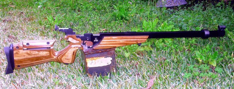

you can make one from your disco that can compete with anything the club has. i made this for my son. and a matching pistol.

WesBob
Vendors
Posts: 2369
Real Name: Wes
Re: Is A Disco 177 10M Practice Gun For Daughter Possible? CO2?
Reply #23 on:
October 26, 2017, 11:51:56 PM »
Nice! That takes some great skill, beautiful!
