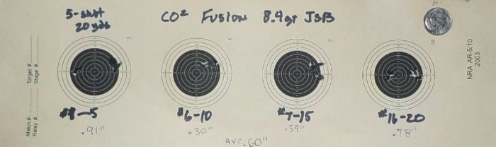

First test:

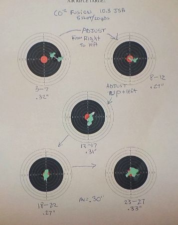

3rd (tonight's) test:
The on/off nature of this ones shooting hasn't been traced down yet. When it's "on" it's quite good for a cheap co2 rifle. When it's off, I can beat it with a smooth bore Benjamin 340.
Right now it's "on"...tomorrow is anyone's guess (about 50/50 chance it will be as good...or as bad at that 2nd test).
It has been like this for awhile...on/off...old LDC, old crown, new crown, new LDC, 3 scope swaps, up in power, down in power, barrel band, no barrel band, bedded, not bedded, clean barrel, fouled barrel,1 12gr, 2 12gr, lubed pellets, washed.dry pellets, and all points inbetween.

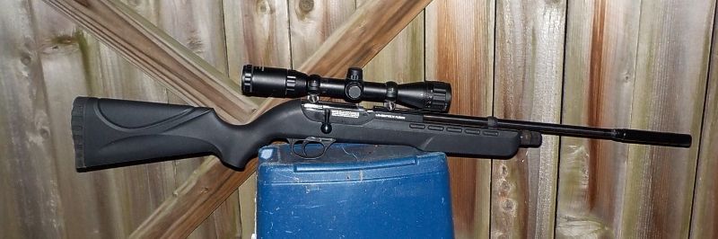

Just a thought. If I was to scrap this rifle for parts. I would maybe add two set screws left and right of the receiver too steady the barrel. From your pics it seems most of the inaccuracies are left to right. JMO
