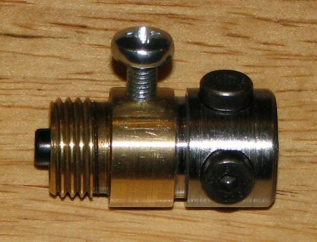

I spent the morning measuring and working on the valve and hammer.... Eric machines the back of the valve to fit inside the backing block to shorten the assembly, and because of the short MRod poppet, I did the same thing with the hammer.... I machined the front of the block for a #016 O-ring....
The stub on the valve is a slide fit into the block, and will be glued or soldered to it to seal it so that the air can't leak below the O-ring on firing.... The nose of the hammer was turned down smaller, so that it won't hit the block and can drive the stem of the poppet below flush.... Here is why....
With the valve and block assembled, the MRod poppet just protrudes behind the block, which is moved forward over 0.20".... The nose on the hammer currently is stock length, and when the flange on the hammer hits the back of the block, the valve will be open 0.25", which is more than we need.... I will likely shorten the nose on the hammer about 1/16" to gain a bit more hammer travel as we don't need 1/4" of lift.... Here are the parts slid together....
The hammer, in this position, is about 7/16" further forward than where it used to stop when it hit the back of the block in it's original location.... This, of course means that the cocking pin would hit the front of the slot in the breech, so I then lengthened that as below....

I spent half the afternoon building a new backing block for the valve to accept two 1/4"-28 screws in the sides, got it all finished, and decided I didn't like it.... There wasn't enough room, IMO, between the O-ring and the side of the screw head, plus it didn't give me a good way to mount the stock.... So, I decided to use the original block, solder it onto the valve so that I could hang onto it, and drilled and tapped two more holes to 5mm x 0.8mm (the same as the current valve and block threads), plus spot faced all three holes.... I had some HoloKrome 5mm low profile SHCSs, which were perfect for the job.... The head is a fraction larger and thicker than a 10-32 low profile screw, but they are still far enough from the O-ring groove.... An alternate method would be to make a new block, using three 10-32 SHCSs with a full thickness head.... The head would then just protrude from the receiver, whereas these are just below flush.... Both are thicker than the tube, however, which is where all the load is taken anyway....
The nice thing about this arrangement is that I can use the original valve mounting hole to accept the pan head stock mounting screw.... Since the front of the stock has been cut off to allow for the tank, it had to be replaced, and this will do a nice job.... This setup has over a 3:1 safety margin in the tube, and the screws are over 4:1 in shear, at 3000 psi, so it's built to laugh at a regulator failure....
