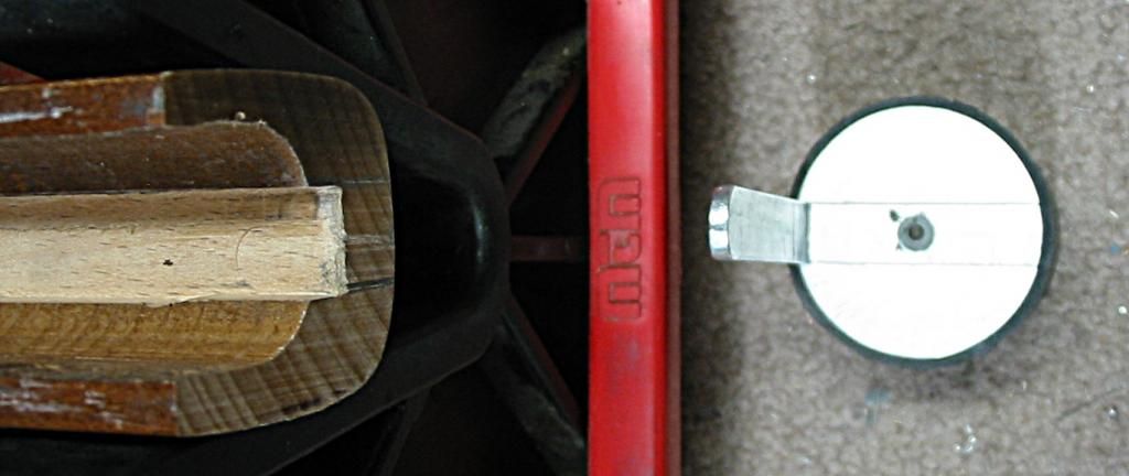

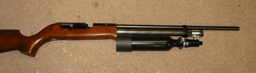

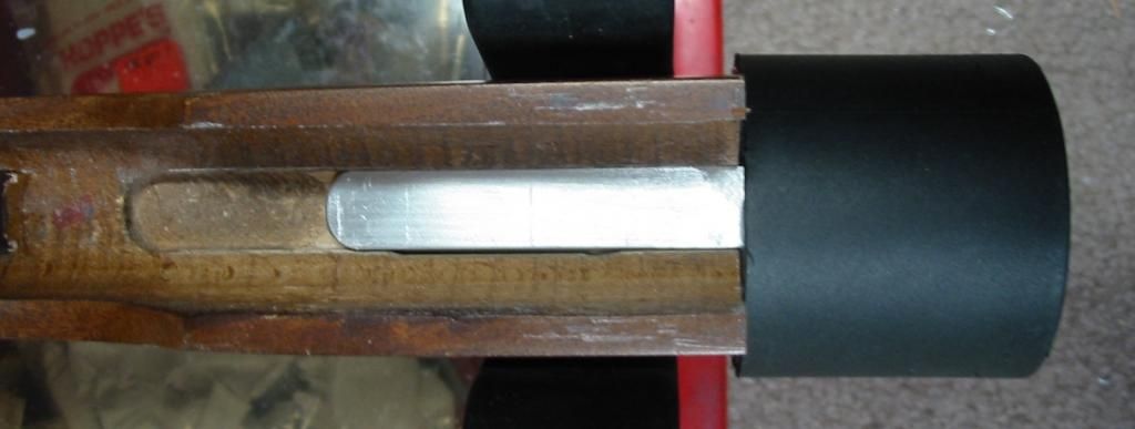

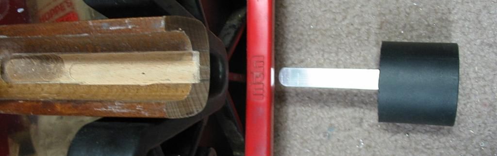

While rsterne and stalwart are off on their mothership fabricating out this world air gun stuff I stayed back on earth awhittlin onna bobcat.
I’m also working on a 1.5K to 2K reverse tanker Bobcat, very slowly, and thought I’d share plus get some ideas on the rear tank attachment I fabricated.
As you can see in this first pic it appears the tank is just floating in air suspended by the upfront tank reverse adapter but it’s not
I whittled (routed) out the stock to receive a fabricated (bent) and angle made out of.125 x .500 aluminum (6010) with a circular attachment piece (.250 thick, 6010) for the plastic bottle holder (left over part from a vacuum cleaner hose extension kit). I have a polyethylene glue kit to fasten the plastic tube to the circular aluminum so I can dismiss mechanical fasteners. ( I saved some of polyethylene cuttings to test)
I cut the circular piece with a hole saw then turned it down on a lathe to fit the plastic tube. I attached the angle to the circle by cutting a keyway to fit then machined a stepped plug to fit in the hole left by the drill bit in hole saw which was drilled and tapped to fasten the angle. I'm to the point right now I'm not sure if I want counterbore the stock, fab a couple of ferrules for the counter bores, for a couple of flat head SHCS to fasten the drilled and tapped angle to the stock or just plain epoxy the angle to the stock.
As far as the fastening the stock to the receiver I plan on making a new backing block, using a couple of extra flat head SHCS for safety then use the OEM hole as a fastening point for the stock with a ferrule in the stock for the bolt to pass through and to keep from compressing the wood (the ferrule will be compress a flat spot on the backing block).
I found great pleasure in shooting the stock Bobcat but I'll take greater pleasure in having more time to shoot without multiple refills with the 13ci bottle.
