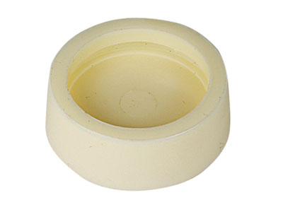

I see that PYramydAir is now selling a replacement seal that says it fits the R7/HW30:
https://www.pyramydair.com/product/air-venturi-piston-seal-fits-beeman-r7-weihrauch-hw30-hw70-marksman-28?a=3661
It does look to be the same, having the "parachute" design. Some of the much older R7's have leather seals -- doubt that's the case with yours. PA is very reliable, so I'd trust this would fit. Even if you seal looks OK, though, for an extra $15, I'd replace the seal if you have the gun tuned.
Paul Watts used to trim down Apex seals on a lathe to fit the R7/HW30 rifles, if my recollection is correct, but he did not sell them separately without a tune. There may be others out there with lathes and the skill and experience to fit a new synthetic seal properly. I see Jim Maccari actually sells a resized synthetic seal for the R7/HW30, now, too.
https://www.pyramydair.com/images/acc/Beeman-Piston-Seal--HW30-R7-HW70_BNP-9070_lg.jpg
While the HW30, being relatively low power, was fairly easy to work on (you will still need a spring compressor), the hardest part of a tune, at least in my very limited experience, can be getting the old seal off (easy enough if you cut it off - the point of no return) and then the new seal back on and properly fitted, especially for the harder synthetic seals like the Apex. It is also pretty easy, if you are not careful to cut or score the edge of the piston seal even after it is mounted on the piston, just by pushing it back in the compression tube. If the seal isn't properly fitted, or its edge is cut or roughed up going back in, then the rest of the tune hardly matters. The parachute style seal is a bit more forgiving than a synthetic seal, though.
All of that said, depending on your level of skill and confidence, I expect that you could probably tune the HW30 yourself with some on line references and advice. You will also need the proper lubricants and spring tar (Jim M sells these, too).
Alas, the folks I have dealings with for custom tunes in the past -- Bob Werner, Gene Curtis, and Paul Watts -- are either no longer with us or no longer doing custom tunes. I know there are tuners out there who are reliable and are doing good work, so research carefully before sending a beloved air rifle off to someone you've never met. A few "custom tuners" out there, at least in the past, were much more adept at internet posting than actually doing a quality custom tune. I am sure there are others here on this site who can provide reliable references more up to date than my past experiences 8-10 years ago. I don't know the going rates for various levels of tunes nowadays, but in general, you get what you pay for, so beware of "bargains".

The seals PA offer are just that "replacement" not OE.
I have used them on a few tunes and they perform rather well. Nice thing is, they have enough of a lip to be sized. very generous amount of material.
