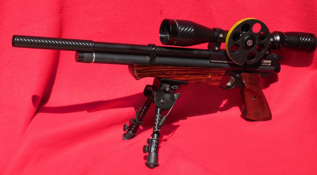

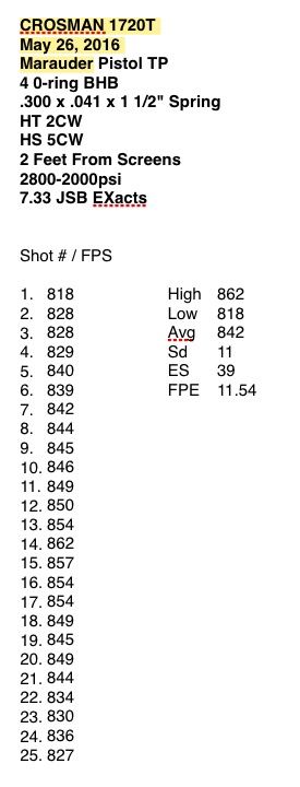

I used four o-rings and a standard (not drilled out) PRod TP
Using a 7.33 grain JSB Exact, these are my results:
This was a 50 foot rifle GTA target earlier this year.
I was the only one using a pistol:
Here is the item in question:

I think the pistol comes with the green port installed at .07. There;s a red one in the box at .05. I drilled oversize the red one to .09.
At .09, 10.8 gr is 710 fps, 8.3 gr is 780 fps.
