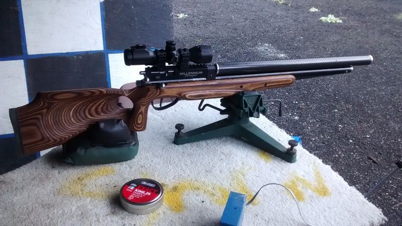

The scope im actually using on this bad boy is a 4-14x40ffp made by discovery its only $350 or something close to that.

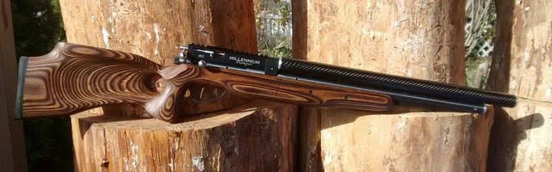

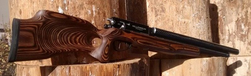

November 07, 2015, 08:58:43 PM »

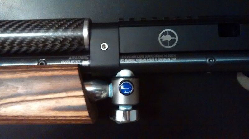

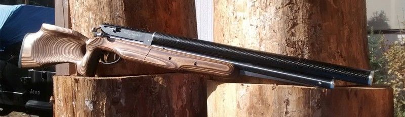

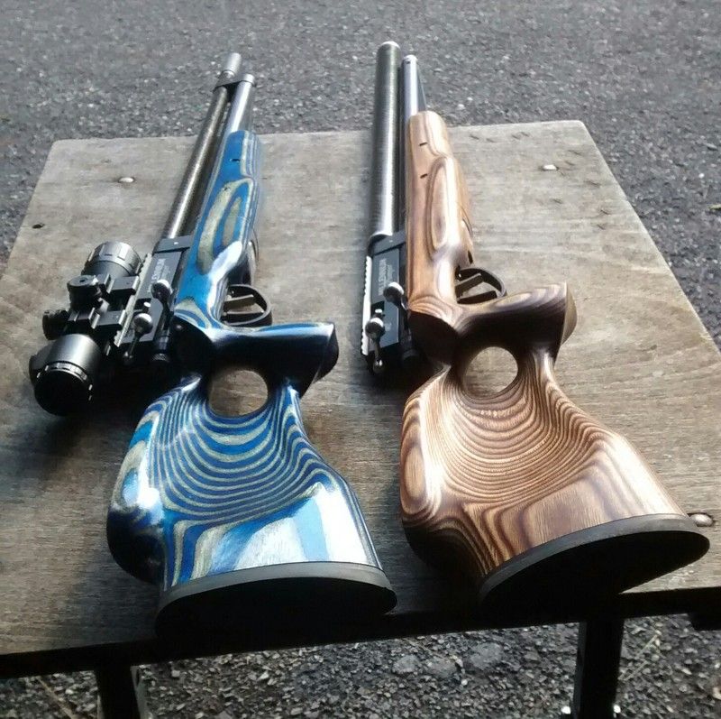

Here's #2 all finished in all Her Glory
She's not mouse fart quiet but sounds like 2 pumps out of a Benji 392.

November 07, 2015, 09:27:59 PM »
Both are very purty.

Reply #806 on:
November 07, 2015, 10:21:26 PM »
The shrouded gun looks very sexy

The Shrouded rifle weighs 8.2 lbs according to my digital home scale (not precise, but close) - I know someone had asked earlier.

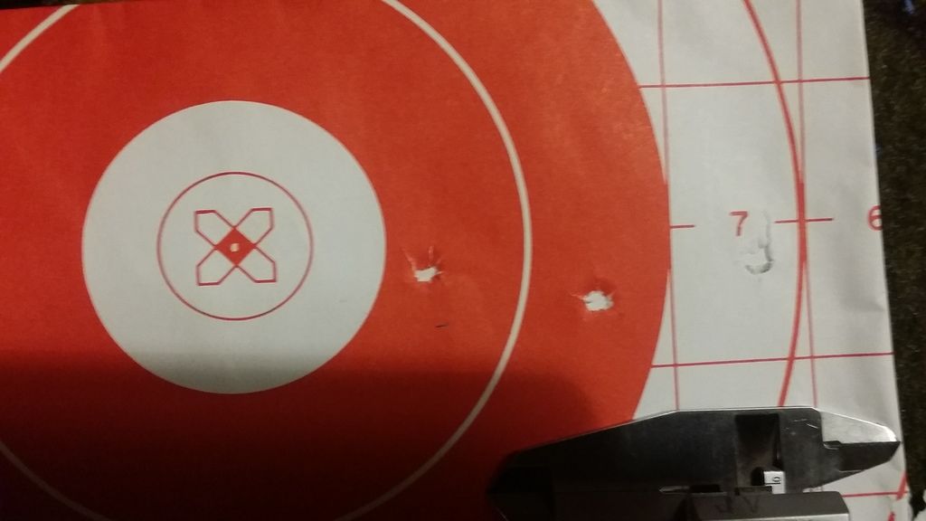

Went to the rage today even though it was windy and raining here is what I got. Remember the wind was bad even my 223 rem was affected quite a bit. What made me really happy was how there was hardly any vertical movment. This is my first and only group cause the wend got worse.

You forgot to post that it's a 100 yard group LOL

Lol yea that might make more sense to people if they knew it was at 100 yards. It was actually quite funny my group was better then the guy shooting his AR right next to me. He didn't know how to shoot in the wind at all.

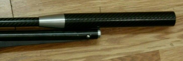

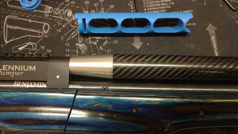

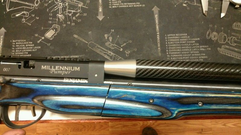

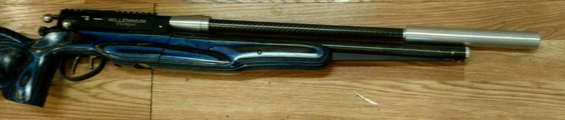

Ok guys, Jeremy has been hard at work on these Shroud monocores & LDC's for the guys that ordered them with those.options.
All the parts will be black Class II anodized - the Shrouds have an extension to aid with objective clearance on longer scopes & to give more front end volume.
Here's a pic of the spacer:
The LDC's are 1.25" OD carbon fiber with a 1/16" thick wall (same as the shroud & *very* stout!) & the CF tube is 9" long.
Both systems do not use any set screws - they tension together using the end cap.
The Shroud holds the barrel in tension & the LDC's can be easily taken apart for cleaning.
I'll be selling LDC's too once this batch is shipped out.
If you want to use your LDC on a different caliber rifle you only need to purchase the correct Monocore & end cap which will save you some money.
These aren't cheap but.you get what you pay for! On top of that they're drop dead sexy
Here's a pic of an LDC tube mounted on Jeremy's 20" barreled Millennium... I'll post pics of the Monocore assembly as soon as they're finished.
The LDC's will have a flat rear cap so you can use them on whatever air gun you choose - I like the slip over the barrel rear cap but it makes them Millennium specific.
The monocores themselves will be laser engraved *For Air Gun Use Only* as well as having the caliber they're made for on them.

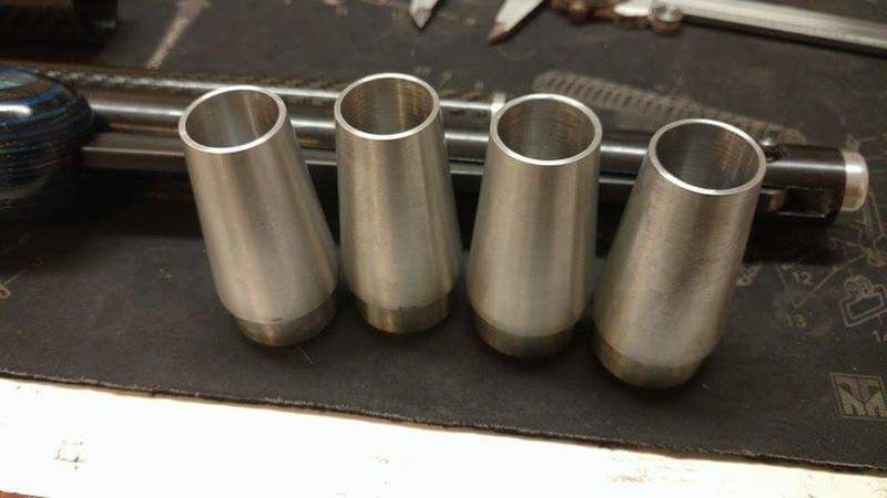

Here's a teaser guys...the 3D print model broke when removing it t but the production monocores will be all aluminum.
Jeremy printed & tested quite a few different designs - this one read 80 decibels... Cocking the rifle read 85
There will be flats on each side at the barrel muzzle that are barrel diameter for free venting into the shroud.
Mike

I have the first .22 numbers...
JSB Jumbo 15.89 grain shot string: (no pumping in between shots - RVA bottomed out)
2000 psi start
1002
977.9
950.9
918.1
878.1
829.3
Reconfirmed 2000 psi for 1 shot
992.6
I think I'm going to have a happy customer.
