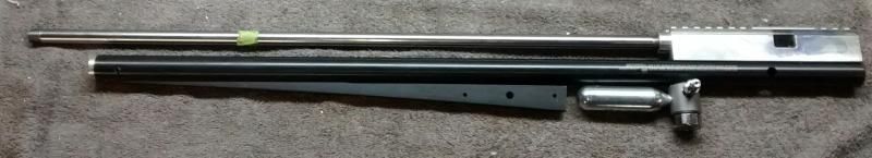

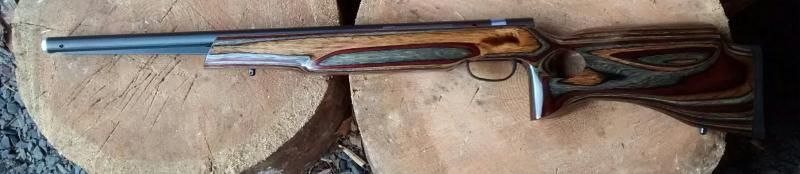

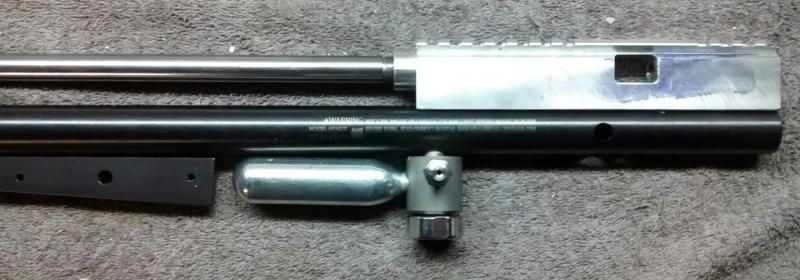

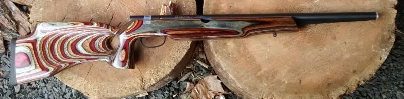

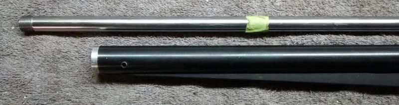

*Update*
I'm sending an assembled lower (minus full internals) to Norm for stock fitting...we're just about done with the power trains then will work on the breech & stick magazine assembly.
We will begin finally barrel assembly once I place my orders for customers barrels - I'm giving folks 1 more week then I'm ordering blanks.
Once that's done the 2 versions of the LDC will begin. Personally I'm going with the 20" barrel and the full 1.25" OD carbon fiber shroud held in tension against the breech band
We're getting closer folks!
Mike
Teaser of the week...I set the lower in my Disco Double Tube stock from my Challenger, just to give you an idea of what it'll look like - my stock is Royal Jacaranda.
