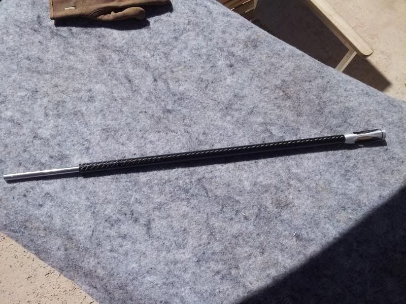

Like Redsail, I carbon sleeved mine as well (TJ barrel), and it's a snug slide fit, using low shrink loctite epoxy to permanently put it on. I used regular masking tape in both ends to avoid epoxy spillage on the barrel.
Also put it in slight tension against the breech, the accuracy was staggering, on a good day (no wind, sorted pellets, and me not drinking coffee) at 25m it's down to 1/32" of an inch (5 shots)
The outer carbon shroud is only covering the barrel from the breech to a spacer near the muzzle that is hold in place by the splitter. The spacer have mounting holes for the front shroud piece that is also vented.
Gun now looks like this
