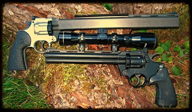

I've had the gun for a few months and I like the gun a lot but like everyone, I need more POWER! And accuracy.
I started with literally the easiest mod in the world, a spring preload adjuster. The gun comes machined for it so its just a matter of finding a nut and bolt to drop in. Then I ground the hammer spring guide down so it wouldn't bottom out on the adjuster slide.
Milan MI
Benjamin 392- polished two stage trigger, thumbhole stock, leapers accushot 3-12x44
Hatsan 125 Sniper Vortex .25-"THE BEAST"~ tuned, lubed, deburred, leapers accushot SWAT 3-12x44, custom stock on the way!
Crosman Quest 1000x- tuned, lubed, deburred, mahogany thumbhole stock, centerpoint 4x32
Dan Wesson 8" silver- centerpoint 30mm dot, polished sears, full stroke mod, 2100 barrel, custom walnut and mahogany grips

Next was to give her a rifled barrel. I used the barrel from a 2100. I cut it to size and the only things I had to do to make it fit was grind the muzzle end down an drill the breech out for the 5/16 2100 barrel.

The final mod (for now) was to grind out the hammer spring retainer so the hammer can get a full stroke on the valve. Then I polished and lubed all the engagement surfaces. Next post will be accuracy testing.

To take the "me" element out of this I used my muzzle loader scope and a rest and shot at 20 feet. The first picture is before the mods using bbs. And the second picture is after the mods. The circled holes are pellets and the three others are bbs. I'll admit it's not the greatest but I have a few ideas in mind to shrink groups. But for now it shoots good enough that I may roll with it and see how accuracy goes as parts wear in.

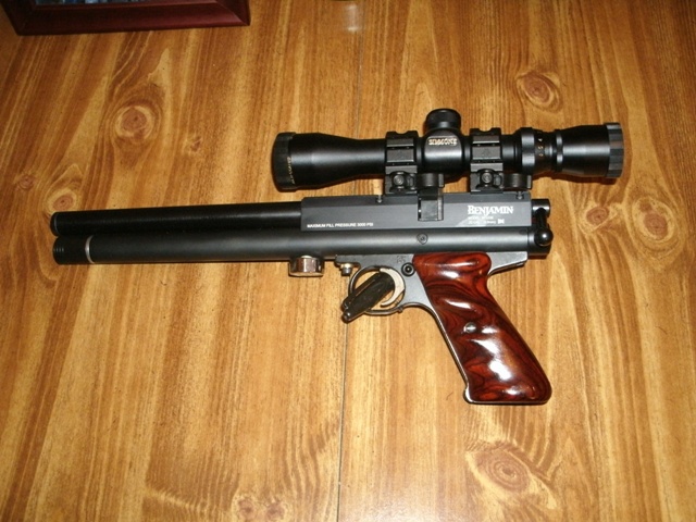

Nice work!! I love the Dan Wessons,good to see people are doing mods to them.
Here is a 357 I did with a 15" barrel that gets 600+fps

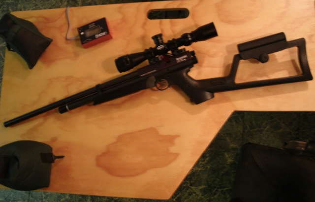

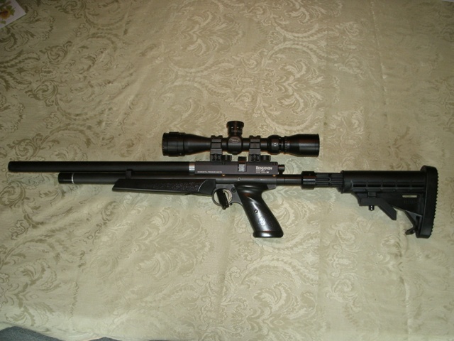

Here are some more ideas.
The top one has barrel housing made from a hockey stick.haha
