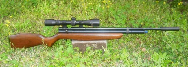

"I just don't like the look of the bottle sticking out the front.".On the 850 it the 88gr cylinder doesn't show - what did you buy??? - Once screwed in, you slide a cover over it ... what's the problem now???
Many air gunners don't like the bottle look. The 850's are very accurate and Roald has done a fantastic job of promoting their full capabilities, either stock modified Co2 or the HPA versions. I chose the HPA version and really enjoyed it. My only complaint with the Co2 is I have no place to target shoot in the winter and I decided on the HPA conversion. CO2 is great when the temperatures are right. I like shooting all year round though.Gene
