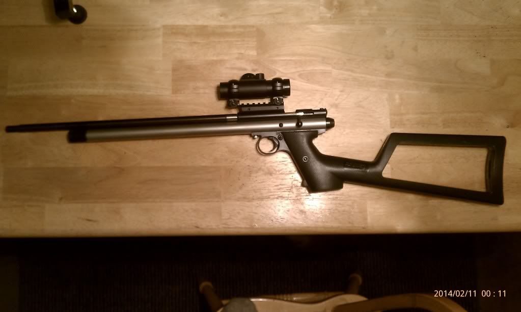

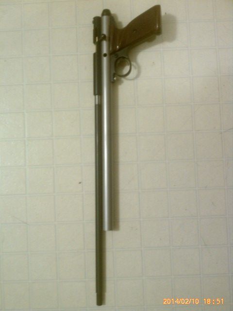

Monkey dad, did you mount the b&a .25 barrel in the crosman steel breech? If so, did you have any clearance issues between that 1/2" barrel and the tube?
12mm LW barrels that are turned down to 7/16" to fit a Disco / 22XX breech will clear the air tube fine without a shim.... Likewise, so will a 1/2" OD barrel, but it JUST touches the tube, not enough to cause a problem, but it does touch.... The .25, .30 and .35 cal barrels that Sean has are all 1/2" OD.... Bob
