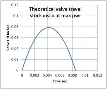

Bob has already done this, but I worked some more on calculating the THEORETICAL travel of the valve stem of a Discovery valve with the spring pre-loaded to near coil bind. I ended up with a graph that looks good but is really of little use.
All theoretical: The 60 gram hammer hits the 4 gram valve at about 19.7 fps. Using conservation of momentum and (for ease of calculation) a fully elastic collision, the valve accelerates to 37.7fps off the seat and the hammer slows to 17.9fps. The graph shows the theoretical valve stem rise to .08" in a little over 4 milliseconds, and then the mirror image drop back to the closed position in a total of 8 milliseconds. In the calculation, only the 2000psi action on the valve stem diameter of .156 ( 38 pounds of closing force) is considered as acting on the valve to close it.
Hmmmm.... basically junk to be picked apart. The lift height of .08" looks reasonable, but in reality, that 8 millisec is enough time to mostly empty the gun's reservoir. Going on empirical data, if the valve opened and closed instantaneously, it would only need to remain open for about one millisecond, and the pellet should be out of the end of the barrel in about 2 and a half millisecs.
So where are the holes in the theory? Please add your thoughts!
One is that it is not an elastic collision. In reality, I think that fact makes the situation worse. There has already been mention of valve stem deflection during the hammer strike, which I think is like a tennis racquet deflecting from the tennis ball and then the ball accelerating to a much higher velocity: preloading a spring and releasing it. But it seems like that would make the valve open faster and higher. But several people have reported better performance with a less flexible seat and stem.
So I am wondering why the valve closes so much faster than theory suggests? Or even if the valve doesn't fully close, the flow basically stops.
Maybe the flow past the valve has more effect than has been thought.
Theoretical valve open time based only on hammer strike
is about 8 millisec. Empirical data suggests open time is
closer to one millisec.

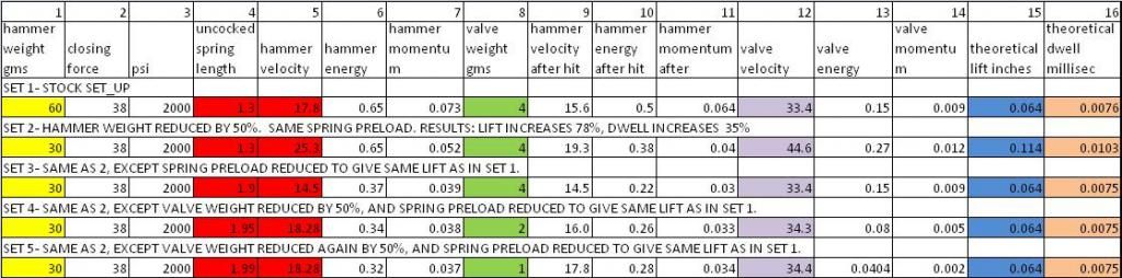

I pretty much agree in principal with all that you have stated and am working on a spreadsheet that will model the valve lift based on spring, hammer, throat, valve mass, pressure, seat deflection, etc. A lot of variables and a lot of energy and momentum being transferred around.
Scott’s comments a couple of posts ago about light weight hammers got the wheels turning, too. What happens when a high vel LW hammer hits the valve?
And I looked at Steve in NC’s equations for lift and dwell (in your opening post), and although I agree with them in concept, instead of using hammer energy and momentum to determine the lift and dwell, I am thinking that using the residual energy and momentum that is imparted to the VALVE is more appropriate.
Using a slightly more robust version of the spreadsheet model that I used to create the single graph a couple of posts ago, here are some numbers. The platform is a Discovery, basically stock, but with adjustable spring preload, i.e., RVA.
The following chart is interesting, but some work still needs to be done to make it more accurate. I feel that the calculations are valid, but that some of the forces that affect the valve are not defined in the model.
The first set of data is for a 60 gram hammer and a 4 gram valve and a stock spring adjusted to about 3 turns less than coil bind. Pressure is 2000 psi, stock valve. I did not take an energy deduction for unseating the valve because it is less than 10% of the hammer’s energy and would not affect the TRENDS that I am trying to show.
So again, in set 1, we have a stock hammer hit with the resulting lift and dwell shown at the far left.
In Set 2, the hammer weight is cut in half, (following Scott's experimentation) but everything else is left the same. Even though the hammer energy did not change (that is governed by the spring, not the hammer weight) the valve lift and dwell increased significantly. If you look at the energy and the momentum of the hammer and valve before and after the hit, you can confirm that the laws of conservation of energy and conservation of momentum has been observed. (Note that if the valve and hammer were the same mass and it was a completely elastic hit, the valve would have taken 100% of the velocity and energy of the hammer, and the hammer would have stopped dead.)
In Set 3, the hammer spring preload has been reduced so that the valve lift is now the same as in Set 1. I find it interesting that the spring preload had to be greatly reduced with the light hammer to bring the lift and dwell back down.
In set 4, the VALVE weight was reduced by 50% and the spring preload again reduced to achieve the same lift and dwell as in Set 1. This time I find it very interesting that the spring preload required very little reduction. I think the fact that the hammer is so much heavier than the valve makes that occur.
In set 5, the valve weight is again reduced by 50%, and again, very little spring adjustment is required to bring the lift a dwell back to the original values.
(click on the chart to enlarge it)
So what does this show? One thing is that hammer weight seems to have a large affect whereas valve weight seems to have little. I think it also shows that it is difficult to change the ratio of the valve lift to dwell very easily. In my calculations, I see that the valve dwell values are much larger than what is really observed in the gun. I am trying to figure out why that is. I am reasonably sure my calcs are correct, but maybe they are not. Also affecting the dwell are the other various outside forces that have previously been mentioned: curtain affect, sonic choking, boundary layer, etc.
Still much to learn.
Lloyd-ss

Wow, what disturbing results.... I hate it when calculations don't agree with reality or theory.... My understanding is that lift is proportional to (residual) energy and dwell is proportional to (residual) momentum, and all practical experiments I have done show that lightening the hammer reduces the dwell, or at least reduces the power of the shot, with no other changes.... When you lighten the hammer, you have to ADD preload to get back to where you were, not reduce it....
With the very high forces on the valve, compared to it's mass (38 lbs. vs. 4 grams), is not the collision completely INELASTIC?.... I would think from the moment of contact with the valve, the hammer and valve move as a unit, being constantly decelerated by the closing force (plus spring force and any pressure differential/drag across the poppet head).... Is it proper to use the mass of the valve by itself rather than the two masses as one?.... Something is definitely wrong, IMO, as this doesn't fit with observed facts....
In addition, how can the dwell numbers you give be in milliseconds?.... Your first graph gave a dwell of over 8 mSec, not 0.0076 mSec.... Here is a graphic representation of what I got for the lift/dwell curve after the valve was cracked....
I was not using actual weights or forces, just relative ones.... I only used whatever the residual energy and momentum was, assuming that the energy loss to crack the valve as the same for all cases.... For the mass, I used the combined mass of the hammer and valve, moving as one, so where I show the mass of the hammer as 50%, in fact it would be slightly less than that.... Using Lloyd's example, a 60 g. hammer plus a 4 g. valve = 64 g., so I would have used 32 gr. which means the hammer would only be 28 g. not 30 g.... For the top graph, I used a mass of 20 units or 10 units, and a closing force of 20 units, giving a deceleration of 1 unit for the heavy hammer, and 2 units for the light hammer.... In order to start with the same (residual) energy, the velocity for the heavy hammer was 10 units, and for the light hammer it was 14.14 units....
The second graph shows an increase in velocity from 14.14 units to 16 units, to achieve the same area under the curve, which I feel represents the amount of air that needs to be released to provide the same shot.... The third graph shows the velocity increased further to 17 units, to provide the same area but including the effects of clipping due to curtain area on the lighter hammer.... These two graphs are only approximate in their velocity values to give a visual representation of what needs to happen to provide a similar shot....

Ha, ha, disturbing results? I think we'll all live, so it can't be that disturbing.
I think what I have shown is that a fully elastic collision is not what is happening between the hammer and valve.In fact, it is so far off as to pretty much eliminate elastic collisions and anything close to elastic. But fully in-elastic where the hammer and valve marry up and track each other? I doubt that too. Probably somewhere in between. Also, I am thinking that the amount of energy that is supposedly lost to opening/cracking the valve is underestimated. You know how if the gun is a little over-pressurized that it seems to take a very heavy hammer hit to open the valve. But once you get he valve to open, it only takes a little more force to open the valve enough for actual operation.
I will play around with my spreadsheet model some more and see if I can get something that tracks with empirical data. Actually, I like the results that Steve's two simplified formulas give. But without his derivations, I am having a tough time getting to that point. I have to say that Steve usually has a very straight-forward approach, and is usually right.
