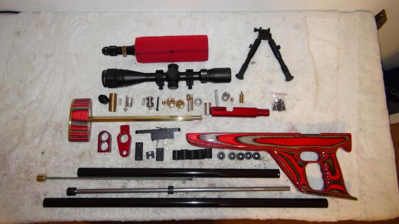

Ok all machining, mods,stock shaping and sanding is done. Now it's time to disassemble redo all the blueprints. Polishing and having the aluminum anodized. Polish the brass and put a protective finish on those. Paint the stock with a clear coat.

Ready for final assembly.

that's awesome!
thank you for sharing and showing the steps in detail!

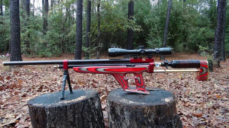

Ok here it is put together. I'll take so better pics this weekend.

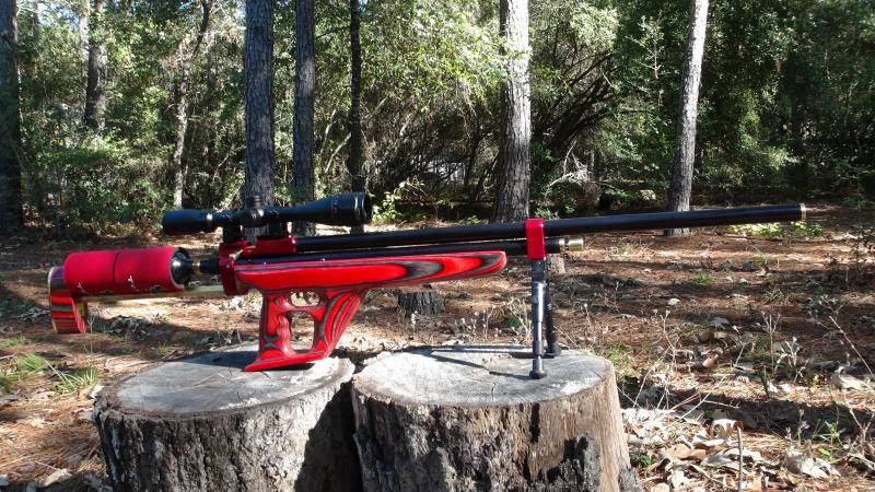

Re: My CO2 Project
Reply #90 on:
November 10, 2013, 06:22:38 PM »
Latest Picture and a video
Last Edit: November 11, 2013, 12:17:27 AM by sixshootertexan
Magnolia,TX

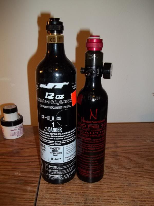

Changing to HPA. Ordered a 13ci bottle from Mac1 regulated at 1400PSI. Should be able to test Thanksgiving weekend.

Diffidently a lot smaller bottle but it should let me test 1400psi on my rifle.

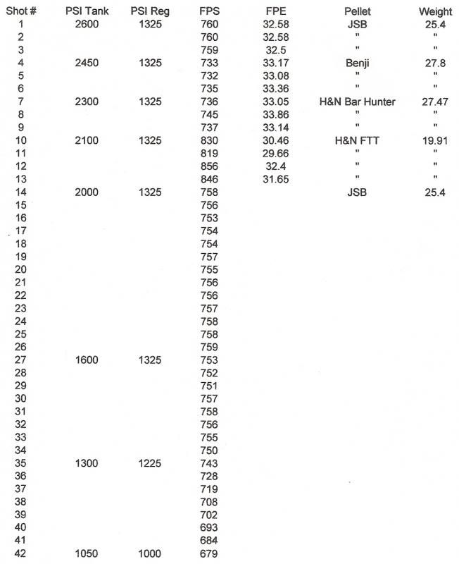

Got the bottle filled today. Happy Happy Happy. 34 good shoots on a fill. Hitting 33FPE.

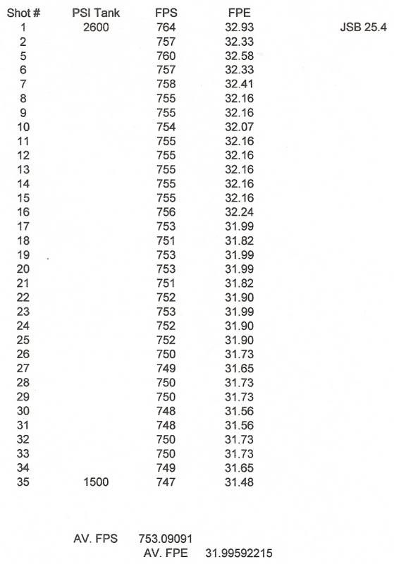

Shot today using just a single style pellet. JSB 25.4gr

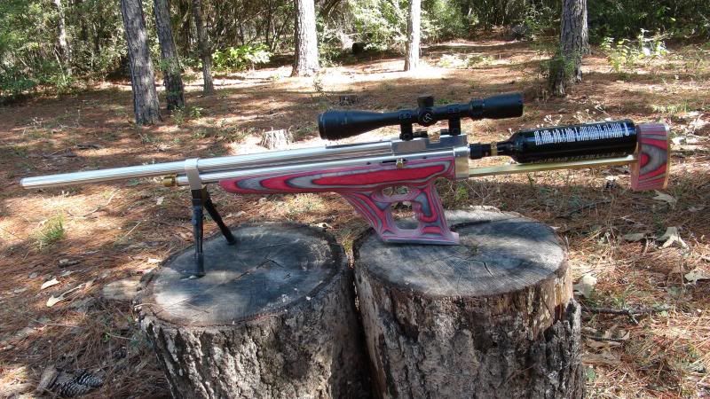

Re: My CO2 Project
Reply #96 on:
December 21, 2013, 05:13:39 PM »

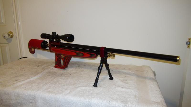

Latest picture with 13ci HPA bottle. Since the HPA bottle is about 1" shorter I was able to cut the brass bar down for a little shorter draw length.
Magnolia,TX

Do you like the HPA better than the CO2?

So far yes. Don't have to worry about it being cold outside. Working on getting a 2000psi reg to try. Hope to break into the 800 fps range.

video of the 1400psi regulated bottle over chrony.
