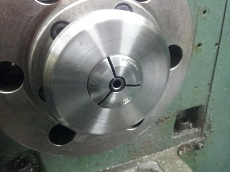

I picked up a Crosman 24" .22 barrel. To me it had a very loose fit so I decided to choke it. I know most people will not have access to this but I wanted to share it anyways. I used a 7/16" 5C collet. I really had to pull hard on the handle but I managed to shrink the barrel by .002". I started with a .218" gauge pin that was snug in the barrel and ended with a .216" gauge pin being snug. Pellets now have some resistant about 1/2" from the end of the barrel. I've never shot a pellet through this barrel. Will be testing it later on. This probably will only work on the soda straw barrels like the Crosmans.
