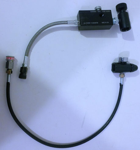

I was using my Fill Station last night and found it a bit frustrating.... I have one I made using a Ninja reg which was factory set to 2500 psi, and a Ninja valve which pushes the pin valve open.... It was very stiff initially, so I lubricated the threads (where the friction was) with Moly (only on the outboard side of the O-ring) and it's much better.... However, it opened really easy, but as soon as it's pressurized, it gets instantly a lot more difficult to turn, either to open or close.... Since I was trying to fill a Disco (2000 psi) I needed good control over the output so I could shut it off at that pressure, rather than letting the regulator do it's job.... Because the knob is stiff to turn, it was hard to shut it off when I needed to.... Even if I was filling to 2500 psi it still would have been hard to shut off (actually even harder from the higher pressure).... This is because of the design of the valve.... The sealing O-ring is large enough that it puts a lot of end force on the threads, causing the friction.... There is a limit to how small it can be, of course, and some similar valves with larger O-rings are impossible to shut off over 1500 psi (I know, I've had some of them).... By comparision, the valve on my SCUBA tank can be opened and closed with two fingers, it has hardly any resistance at all because it uses sliding components and a balanced design.... In order for this fill station to be more useful (and IMO safer), I think it needs a balanced design for the valve so that it can be opened and closed effortlessly and with good control over the flow.... This would be CRITICAL for the design to be used without a regulator, of course.... I hope Ninja address this issue on their new fill station.... Since it's only "on paper" at the moment, I thought it might be a good time to mention it....Bob
You can't slowly eak out the air to fill disco.

I used my regulated 2000 output one for the first time today. It was very easy to control the fill rate, and I would think after trying two fills that you could stop at about any pressure in the gun you wanted.Bill
