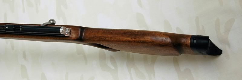

Got a "new" one today, a used .177 cal "SMK custom B2" which has a very nice stock.
Will tune it in the future, quite busy at the moment...

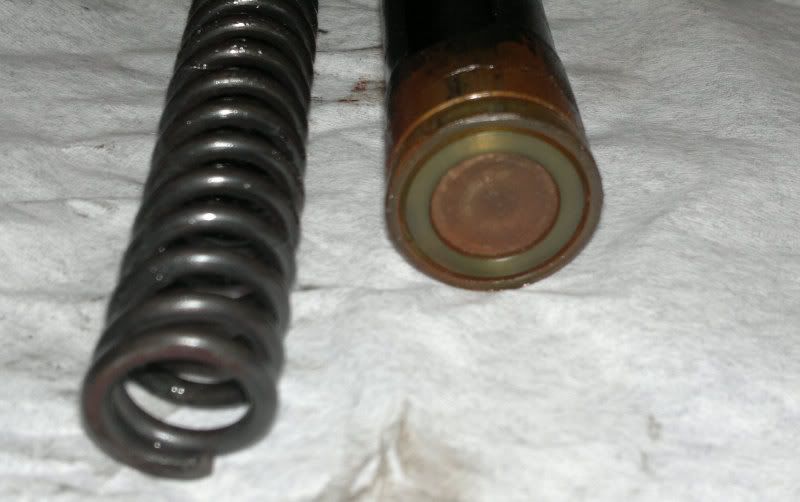

Work in progress
Waiting for a new piston seal and 2 delrin rings for the spring guide....

Tweaked the spring, replaced the piston seal, only one delrin powerband on the spring guide, shoots very nice now
Also includes stripping and re-assembly so it's a longer video than the most I post on YouTube...
Sure hope it triggers a few people to start tweaking. Lots of downloads on the CharlieDaTuna website to get you started !!!

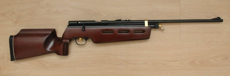

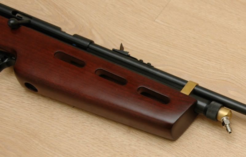

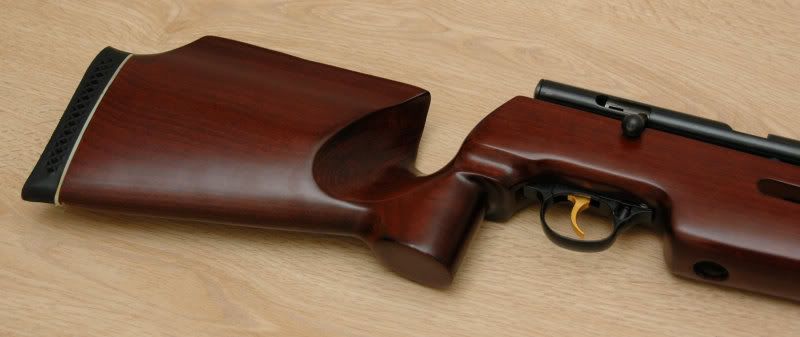

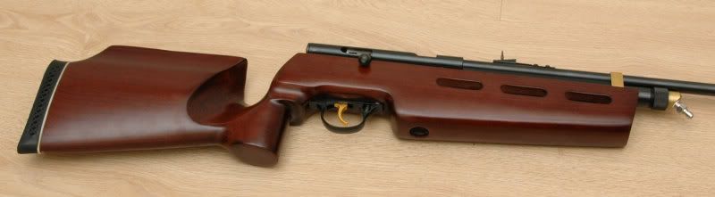

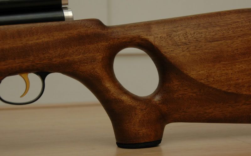

The target stock and .177 cal QB78 I bought used last weekend have been delivered today.
You might notice most of the custom parts have been removed from the rifles, these are stored since I still have probs after importing an XS60C April 2011, it still hasn't been released from customs yet and haven't heard from the justice dept., payed them a visit for a chat last fall. I live in the Netherlands...
Last pic from top to bottom:
.177 cal XS79 w. SeanQ custom stock (UK) which I still have to finish for personal preference after which it will be stained oak and laquered afterwards.
.177 cal QB78 which arrived today, the barrel will be switched with the 79, standard will be breech fitted, AR2078 breech shown in the pic kept as spare
.22 cal XS78 tuned to about 18 fpe w. bulk fill and... w. target stock which arrived today

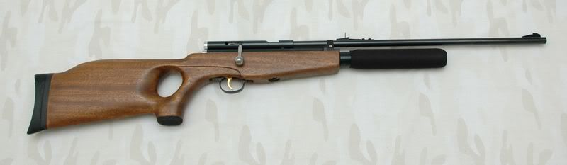

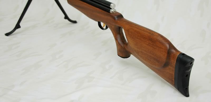

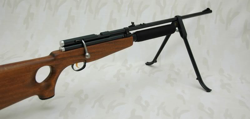

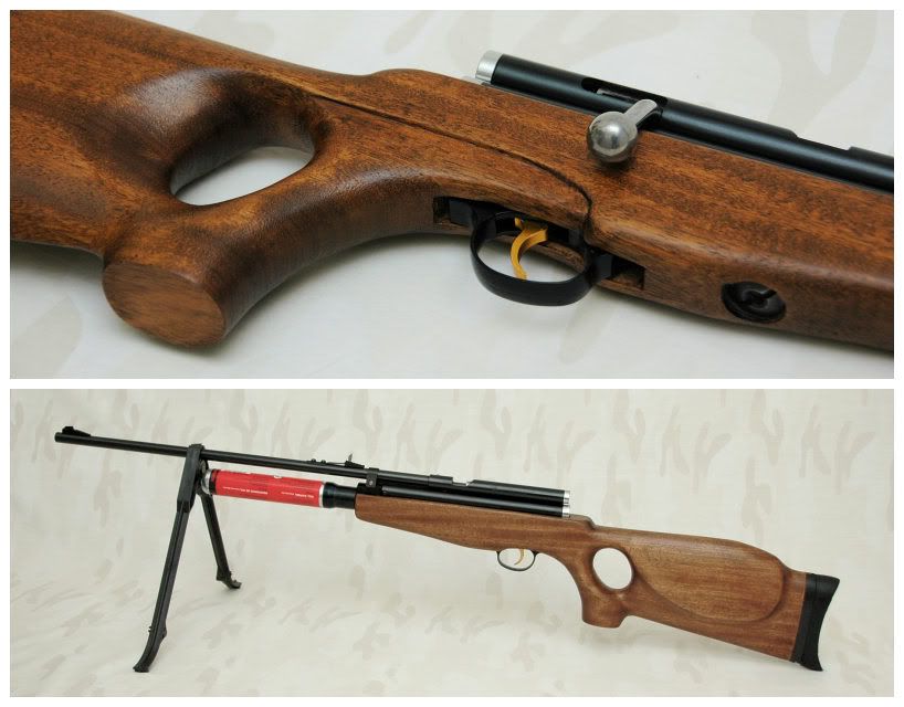

Has been blinged a bit today

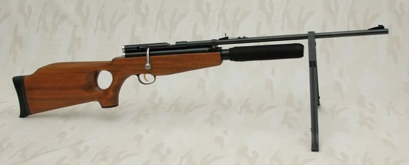

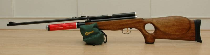

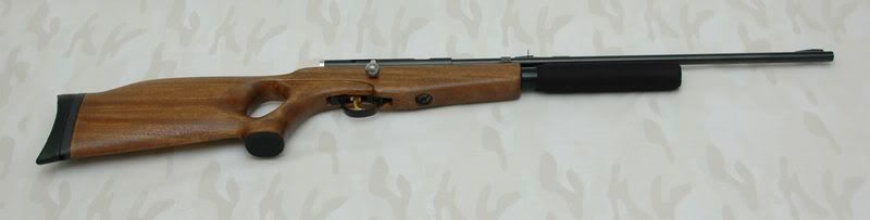

Scoped and ready for a shoot on Sunday

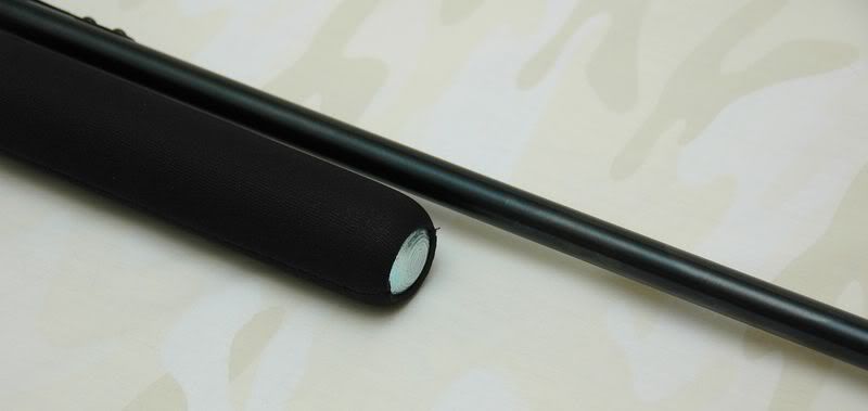

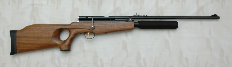

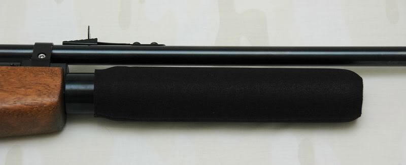

Purchased a neoprene bottle cover, project finished

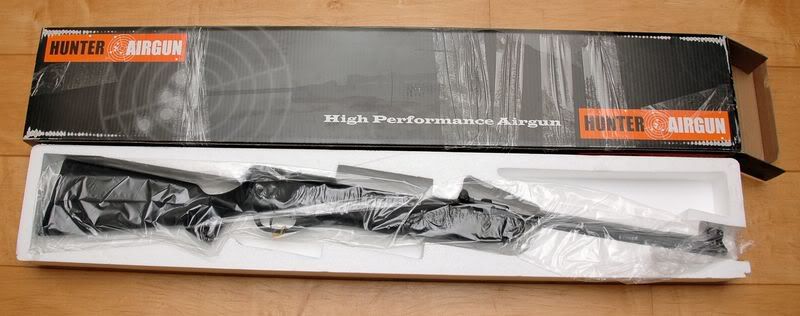

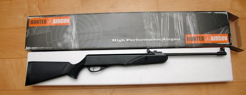

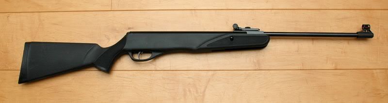

New .22 cal B19 w. synthetic stock...

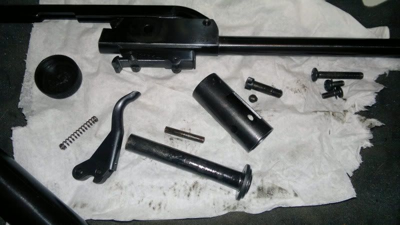

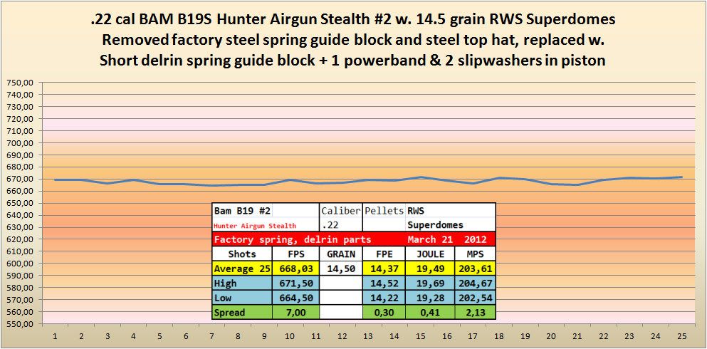

Bought two of these Bam 19s rifles, detuned the one I'm going to keep, replaced the steel spring guide block and steel top hat, finished both spring ends, sharp edges removed, spring ends polished, molied the spring, used a delrin custom shorty spring guide block with one powerband and instead of the steel top hat two delrin slipwashers in the piston:
