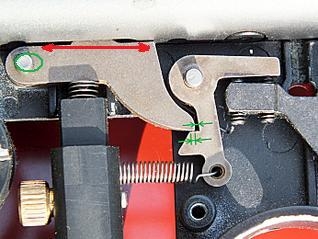

Hello, excuse my english !! did as on my picture (surrounded in green) no need to press the trigger even with the hollow hammer:

That should work, I have thought of it before.... The only drawback is that the hammer must be withdrawn further to cock because of the sear sliding back.... This is only a problem if you are trying to achieve (or maintain) greater hammer travel, of course....

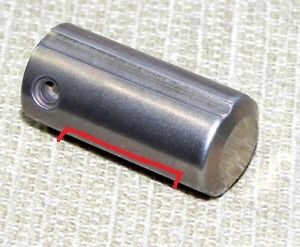

OK, thanks !! I do not want to lighten my hammer too much! I can just make a hack down the hammer! it's possible?

You can grind away part of a hammer to lighten it.... but unless you remove quite a large amount of metal you will not notice any significant difference....

one more thing ! if I reduce the hammer to lighten it by keeping the spring oem of the valve! I will not lose fps?
what are the best settings for a discovery and custom valve, 3000psi and power adjust and prod trigger group, prod hammer?

Yes, lightening the hammer with no other changes will lose velocity.... Usually a turn more preload on the hammer spring will gain it back again.... There is no such thing as "best settings", that depends entirely on your goal, and the pellet weight used.... If you are going to use 3000 psi instead of 2000, you will likely need a heavier hammer, not lighter, and will probably need a much stronger hammer spring as well.... If the ports in the custom valve are large, then most likely you will need even more hammer strike to open it.... If you go far enough, the gun will become nearly impossible to cock....
There is a definite relationship between the FPE output of the gun and the hammer strike needed to produce that.... Unless you use a balanced valve design, more power means the gun will be harder to cock.... and in fact that can become the limiting factor on FPE and caliber for any PCP design....
