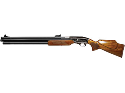

LloydAwesome concept! I had the idea myself but not the talent to pull it off! LOL! Anyway I found your site and signed up for one (raw or unfinished if you please). Any plans for doing the same with the Marauder plateform?Ray
Lloyd,I have a couple of comments,Great and simple idea on your part.You cant Anodize chrome moly. You can only Anodize Aluminum.I think you have a filler valve on the new tube. Why not just have a cap at the front end for possible cleaning purposes . Why not just a cap at both ends just to seal it . If the two tubes are connected together and the connection is sealed by O rings or some such method then you only need the one filler valve on the upper tube.You will probably need a small spacer block between the two tubes so that the 2nd doesn't jam against the upper filler tube. This would mean welding the block on the lower new tube and contouring the upper surface of the block for a tight contact with the circumference of the upper tube.This is starting to get difficult to manufacture. Maybe you could explain your idea further.Jim
