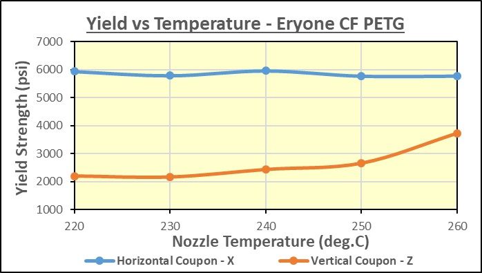

Not sure how I missed posting it, but a week ago or so I tested Eryone CF-PETG.... Here are the results....
The horizontal (X-axis) strength was pretty flat regardless of temperature, but at 6000 psi max. it wasn't as strong as Overture PETG with no carbon fibre!.... The vertical (Z-axis) was also significantly weaker than the plain PETG, until the temperature got to 260C, at which point it was basically equal.... I was not impressed with the Eryone....
Yesterday and today I tested the French made Kimya PETG-CF, which is pretty pricey at $50 per 500g roll at Digitmakers.ca (it's not easy to find), which puts it in the same price range as 3DXTech's PETG-CF at $76 per 750g at the same store.... I really liked this filament, finally I am seeing the X-axis strength bump up significantly more than straight PETG, into the same range as PLA.... Here are the results....
At some point I hope to test the 3DXTech offering in CF-PETG, once my wallet recovers a bit!....
OH!.... One more thing.... I took a closeup photo of the broken Z-axis coupons at various temperature, from 220-260C.... Here they are, left to right.... Click to enlarge....
You can clearly see that at 220C the layers are distinct and separate, and the hotter you go, the more melting and fusing that occurs between the layers.... By the time you get to 260C, you really can't see the layer lines any more.... This shows why the strength in the Z-direction increases with temperature....

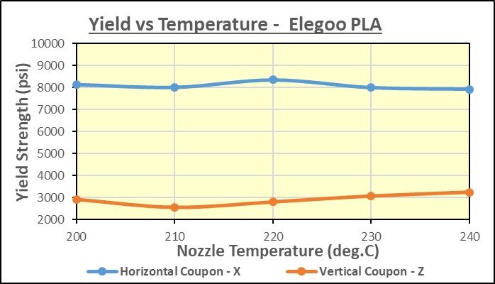

I decided to run a test on the Elegoo PLA that I bought for my 4-player Chess set.... I had a bit of extra red, and here are the results....
I have modified the coupons yet again, reducing the hole for a 5/16" pin instead of 3/8".... as I was still getting an occasional failure through the side of the eye, where my FEM analysis said the stress was high.... I think the bending at that point as the coupon stretched was the reason, and reducing the diameter of the hole straightens out the stress lines there.... The coupons are still giving the same values, but they are even more consistent, and I have not had any more fail except right where they should....
The Elegoo was typical for the Yield strength in the XY plane, and all 5 coupons stretched in the middle after they yielded.... All the Z coupons broke cleanly right in the center.... The layer adhesion was not as good as some other PLAs, but better than the wood-filled one.... That may be a function of the colour, if I have enough of the blue, white and black left over I will test them at 220C (where the red was the strongest in the horizontal) to see if colour makes a difference....
NOTE: I tried the three other colours at 220C (the strongest temp) and found VERY little difference between them.... They were all within 10% in X and 12% in Z of the average yield strength.... In these tests, the White was the strongest in X but the weakest in Z.... If you want to be sure about your particular batch and colour of filament, testing it would be the only sure way....

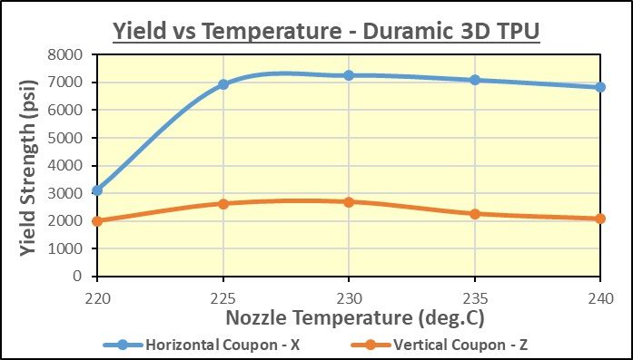

I received a sample of Duramic 3D TPU from a reader, and ran the tests on it.... twice!.... The first couple of coupons were OK, but as I got deeper into the (re-rolled) sample, it was wet, and the coupons became rough, pebbled, with a frosted appearance, and the strength dropped.... I dried the filament for 12 hours at 50-55C, and then it was fine.... Here are the results for he dried filament....
There was a huge increase in strength between 220C and 225C, after which it leveled off.... At 220C, the horizontal coupons failed because the layers were separating across the coupon, particularly where they were bonded to the sides of the "eye".... At 225C and above, that did not occur, even at maximum load.... The peak strength occurred both in X and Z at 230C, and all samples had a high gloss....
Boy, does this stuff stretch!.... I increased the travel rate to 20mm/min. (from 5), and the stronger horizontal coupons stretched 170mm in 8.5 minutes before snapping.... That is to over 4 times their original length!.... Elastic materials certainly do not follow the rules, as when you take into account how small the section was (about half size in width and height), when they failed the stress was about 4 times that shown in the graph above (ie approaching 30,000 psi).... Of course that is not how you do it, but it shows why things like tennis racquet strings can stand the tension that they can, by stretching....
One thing that occurred to me was the thought that this material might be usable for transfer ports.... It recovers most of its stretch, unless you way overdo it, and it's tough!.... If the OD was contained in metal (such as the recesses in a barrel and breech) it might be possible to make custom, stand-alone transfer ports from it.... Print them vertically, so that the layers are in compression, and the outer walls are contained by the recesses, and they might work really well.... Just a thought....

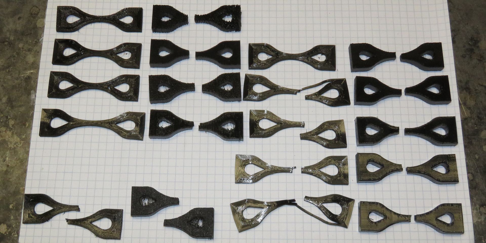

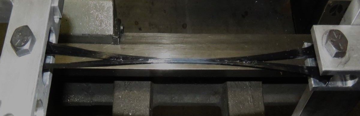

Re: Tensile Strength Testing
Reply #132 on:
January 09, 2024, 02:15:39 PM »

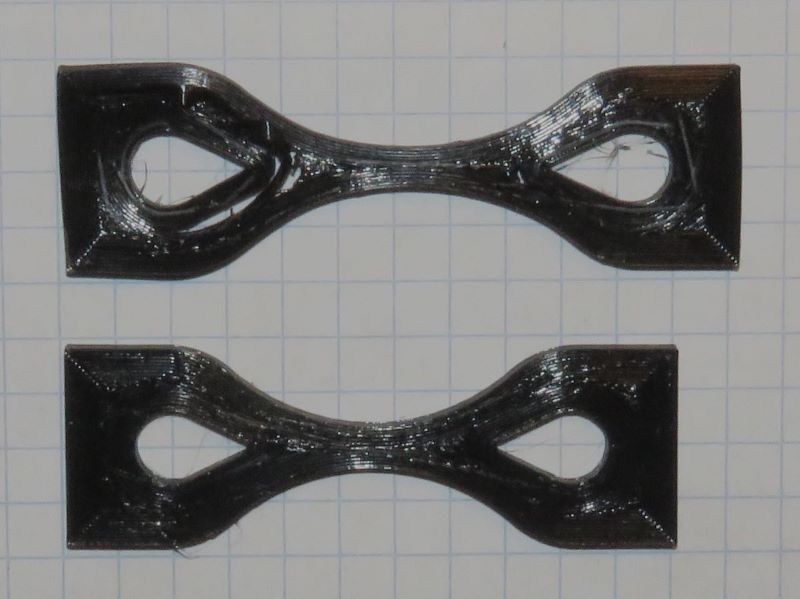

Here are the coupons from the TPU testing.... First a horizontal (X) one at 220C (wet), before and after testing.... Note the delamination, which did not occur above 225C....
The next is one on the torture rack, again a horizontal one....
Here are all the Coupons after testing.... The left column is horizontal (wet), second column is vertical (wet), third column is horizontal dry, right column is vertical dry....
The top row (L only) is at 210C, horrible finish, virtually no bonding.... Second row at 220C, third at 225C, fourth at 230C, fifth (R only) is at 235C, and the bottom row is at 240C.... Note the rough finish and stringing on the wet vertical coupon at 240C.... That is when I decided I had to dry the filament....
Last Edit: January 09, 2024, 02:19:15 PM by rsterne

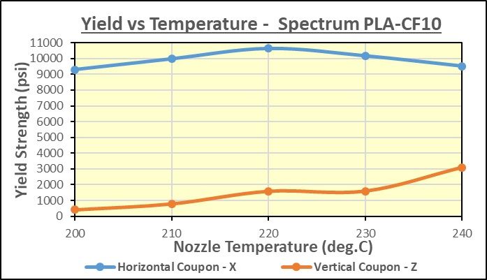

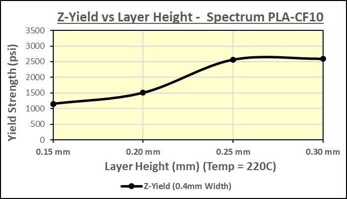

January 29, 2024, 05:20:19 PM »

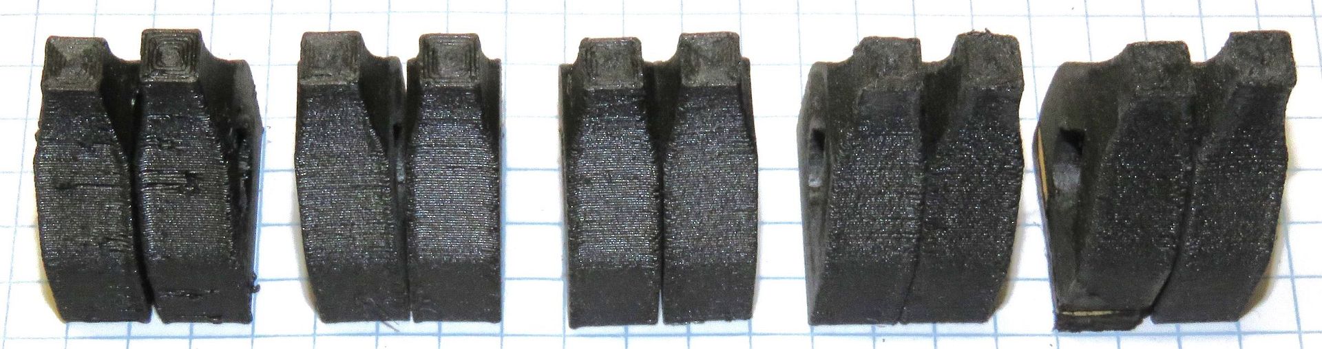

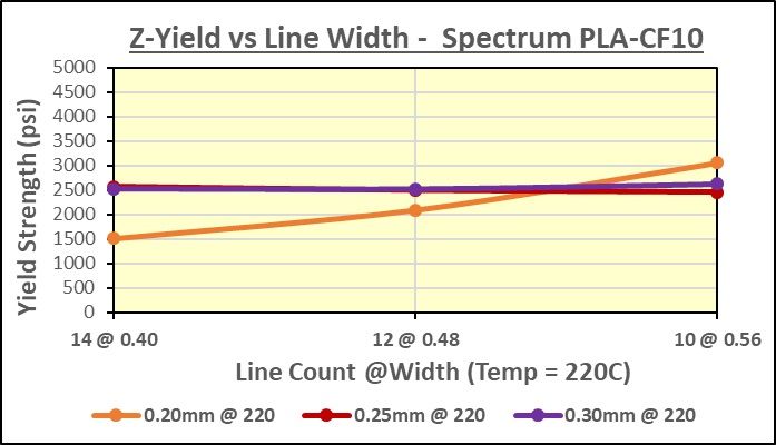

I got a sample pack of Spectrum (Polish) filament, with 5 different plastics, all with a carbon fibre fill.... The first one I tested was the PLA-CF10, which as the name suggests has 10% carbon fibre content.... Here are the results, plotted vs temperature.... Printed with a 0.4mm nozzle, at 0.25mm layer height and 0.40mm line width.... pretty much standard settings for CF....
This material is a bit stronger than any other PLA I have tested in the horizontal (X) direction, but quite weak in the vertical (Z) direction.... The layer to layer adhesion is not great.... I was curious about how layer height and line width affected the strength, so I did some more tests.... First of all, the horizontal (X-axis) strength does not appear to change when these are varied, total variance was within 3%.... However, the layer to layer adhesion changed quite a bit.... All the tests were done with a 0.4mm nozzle at 220C.... above which the horizontal strength drops.... Here is what happens when you change the line width.... 0.40mm is 100% of nozzle diameter, 0.48mm is 120%, and 0.56mm is 140%.... The number of walls in the test section (0.56 x 0.56mm) is also given, along with the line width, in the X-axis labels....
Note that with the 0.25mm and 0.30mm layer height there is virtually no change in the yield strength in Z as you change the wall thickness.... However, with the 0.2mm layer height, increasing the wall thickness greatly improved the strength.... With this in mind, I then tried four different layer heights, again at 220C with a 0.40mm line width, and got the following results....
It is quite obvious that as the layer height is increased above 0.20mm, the layer to layer adhesion increases a lot.... I'm guessing this is why a 60% of nozzle diameter minimum layer height is recommended for carbon fibre filled filaments.... Possible the inclusions in the matrix from the particles requires a thicker layer for optimum strength.... One wonders if the same thing applies for wood filled, silk, or matt filaments, which tend to have weaker layer adhesion?....
Reply #134 on:
January 30, 2024, 02:40:32 AM »
I'm curious what temperature range the vendor recommends for the PLA-CF10?
Would it make sense to do the tests at 240C, or higher, where the Z-axis strength is strongest, rather than the XY? XY is already quite strong, the Z is the weak link. Granted, that is very high for PLA, but if it still prints well, why not?
They suggest 60% or more layer height vs line width, yet the best results for Z strength were at 36% of your widest 0.56 line at 0.20 layer height. Are their recommendations based on 0.40 wide lines only? Seems like they should have a recommended minimum layer thickness value rather than percent based on your findings.
I'm also curious what happens on the tri-color chart if you go further right -- 0.64 0.72 0.80 wide? If 0.25ish continues to be the strongest layer thickness, 0.70ish (or more) is looking good for a line width...

Spectrum only recommend 190-220 for the nozzle temperature for the PLA-CF10.... On all my testing I always go 10-20 deg. higher.... Print quality is usually pretty bad at the highest temperatures I test (so much stringing I have to clean out the holes in the vertical sample to get the pins through, and rough surfaces)....
It is my understanding that the limits for layer height are 25-75% of the nozzle diameter (some sources say 80%), so with a 0.40mm nozzle that is 0.10-0.32mm.... I have never seen a maximum width listed, but it apparently depends on the outer diameter of the nozzle tip for the absolute maximum.... I agree I should test even wider widths, but I have never seen anyone publishing data at over 140-150%, so there must be a reason for that.... Have you tried it?.... I did do some at 150% (0.60mm) which printed OK, but on the bottom layer I started seeing gaps between the lines.... Increasing the flow might cure that....
The test spools are only 250g, and I ran out before I could do any more testing.... I certainly plan to push the limits on the PETG-CF filaments to increase the Z strength, I just tested one where the X was over 10,000 psi, and as you say the layer-to-layer adhesion is definitely the limit.... I am also seeing a trend that as you get a stronger X, you get a weaker Z.... Perhaps the material becomes so rigid the stress gets more and more concentrated on the inter-layer adhesion?....
