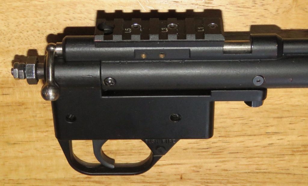

I went old school on mine and tapped the receiver and mounted a short piece of Picatinny rail....
I was only using a Red Dot, but with an offset 1-piece mount you may be able to accommodate a longer scope....
