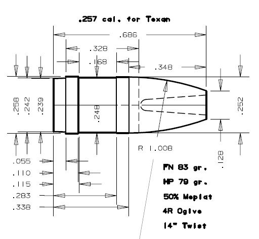

I use Case Wax for resizing, if the slugs are a bit on the large size.... Some of the shorter NSA slugs are actually smaller than 0.250" because the nose ogive goes all the way to the base, they have no parallel section to ride in the rifling.... The NSA website mentions that for 33 gr. and lighter, IIRC....
Part of the issue with AF guns is that the chamber is made for pellets (even on the Texans), rather than being long enough for chambering slugs without extra effort.... A lot of guys shooting slugs with Condors, etc. ease or lengthen the chamber.... I designed some slugs specifically for all the calibers of Texans at the request of NOE, with a partially bore-riding nose of smaller diameter, but unfortunately they never reached production....
Above is the drawing for the .257 cal version....
Last Edit: April 09, 2021, 06:26:01 PM by rsterne
