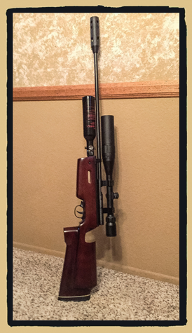

By the way William, I sure do love my AR2079b, it looks just like yours. Even more now that I have a regular size scope instead of the compact one in the pic below.
