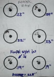

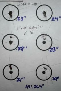

Most tests (and some at 40yards):
With three pellets really in the running at 20 yards, each got a 30 shot test at that range to rule out “freak”groups.
Eun Jin. Felt right when chambering, but could benefit from careful selection. All they got from me in this test was a quick visual check (removing the dented, deformed, or odd-ball ones):
JSB 10.1gr. These fit loose in the barrel, with very little resistance felt when chambering.
Kodiak 10.6gr. These seemed to fit “right” in the barrel, with a little bit of resistance when chambering.
So the winner at 20 yards is the Kodiak. Will test the others as time allows; wouldn't be the first time a 2nd or 3rd place 20 yard pellet took 1st place at 40yards but I have to go with the odds.
