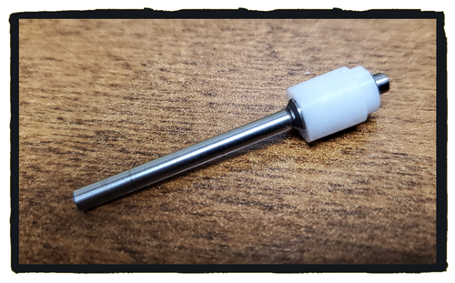

Well she is still leaking ... I will do a balloon test next ... I can't believe its the poppet and I will be very surprised if it is !wll
Quote from: wll2506 on October 07, 2019, 11:12:09 AMWell she is still leaking ... I will do a balloon test next ... I can't believe its the poppet and I will be very surprised if it is !wllOK, I did the balloon test ... and the balloon filled up ..... I do have a poppet leak after changing the poppet three. I will make another poppet out of white Delrin and see if that works.I'm starting to get annoyed big time.;-)wll
epoxy with tight fit that requires a 1 ton press. so a “press fit”
Quote from: darkcharisma on October 10, 2019, 01:41:36 PMepoxy with tight fit that requires a 1 ton press. so a “press fit” I have a ton press so I'll try that. What size hole do you drill, about a .155 for a tight fit.wll
well if it doesnt help. there is another solution. get rid of the c clip. and make a cap poppet sealed with epoxy to get rid of the possible air escape route in the center.
