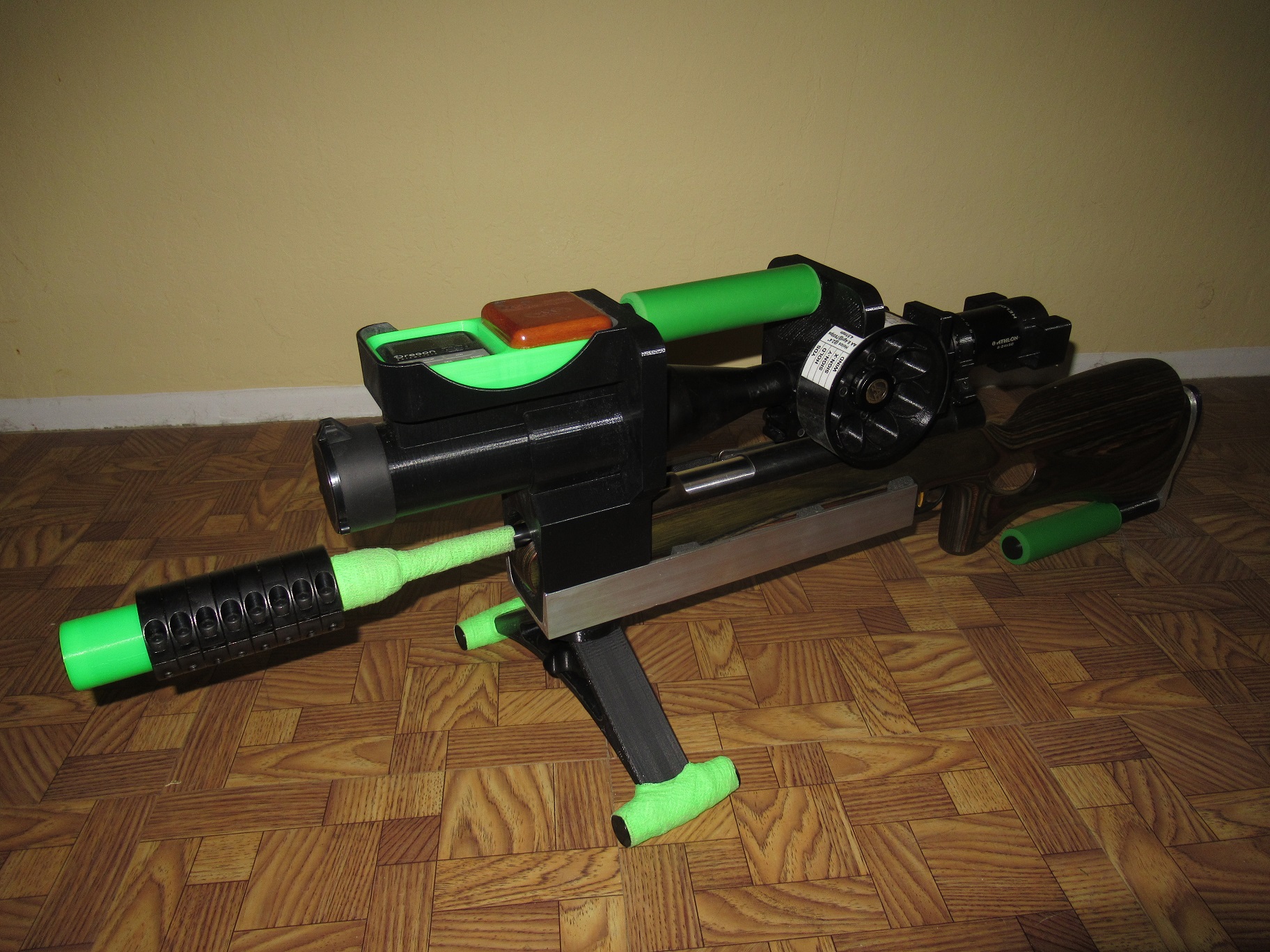

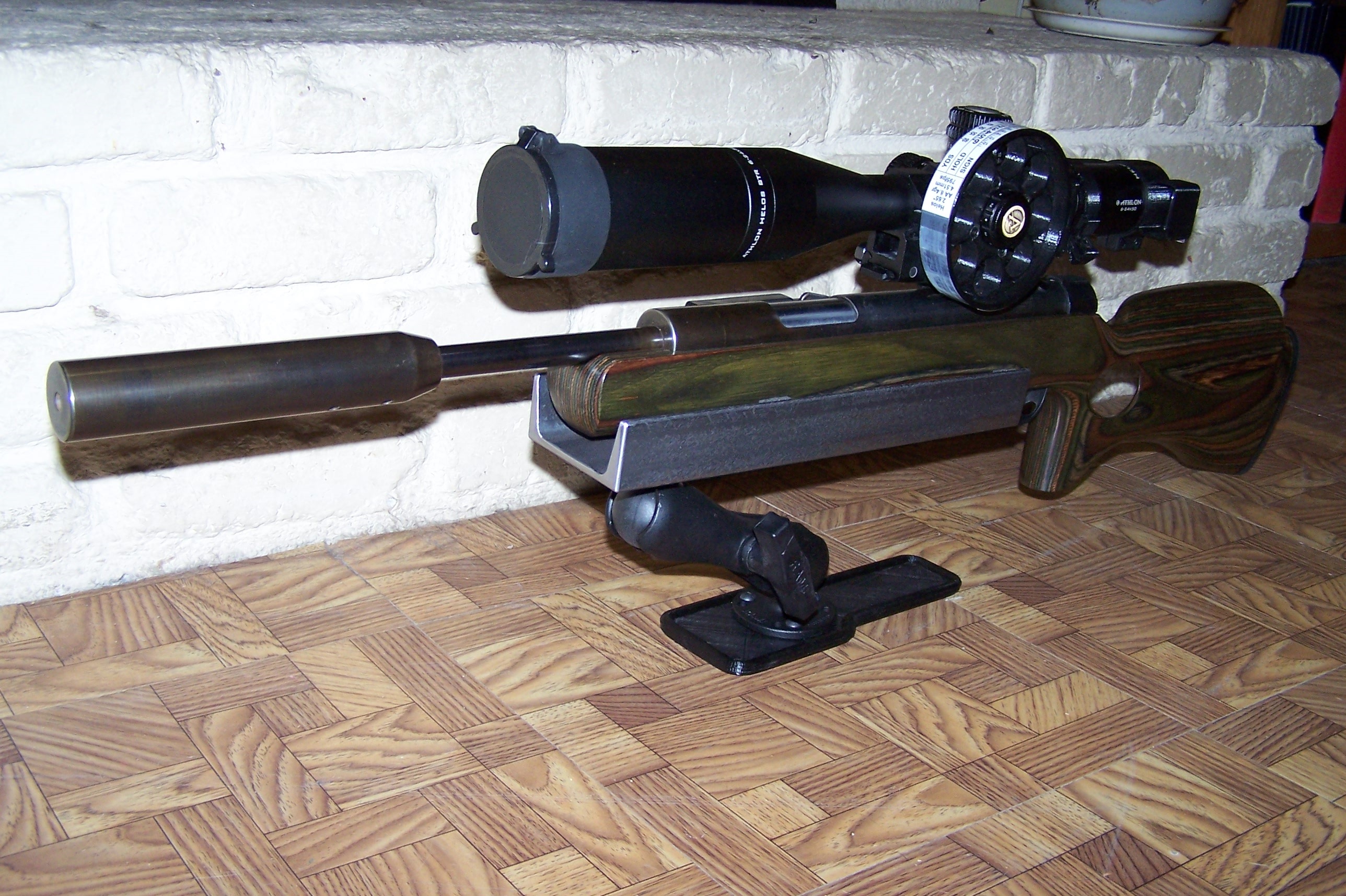

I'm getting ready for next year with a little more emphasis on WFTF. Though I still plan on shooting in Hunter and Open some times.
I've made too many changes at times and then it's harder to evaluate what is actually helping. So I'm taking it a step at a time. OK - a couple steps at a time.
After the recent 2018 National match, the first thing I did was shorten the gun about 3" so that it would fit in a case that is legal on all airlines as checked baggage. I will be flying to a match at least one time next year. My rig was at 12 lbs originally, which is a good compromise for a 12fpe piston gun. I lost about 1 lb off the end of the muzzle when I shortened it and decided that the resulting 11 lb total weight was too low. I shot it just little bit that way. Lighter weight makes a piston gun harder to control and it's harder on scopes. I've seen piston FT guns weighing a lot more so I decided to add some extra weight during process. First I added an Anschutz style rail. The rail addition adds nothing by itself, but it gives me a convenient way to add other weights and accessories to test out.
The C-channel added about 4.2lb. and the ram mount about 1.5 lb. bringing the total to about 17 lb. I can swing the Ram mount forward and rest the flat channel on my knee for most shots, same way as I shot before. If I need some extra elevation for high angles or obscured targets, I can extend the hamster a few inches. That might also help on standing and kneeling shots.
Our club had an FT match in Cambria last Sunday. I tried the QB58 with just the C-channel (no hamster). I was also testing a new scope with higher mounts and new dope. I got the same score as I did the last time I shot in the old configuration on that same course. So far, so good. I'll add the hamster into the mix for the next match.

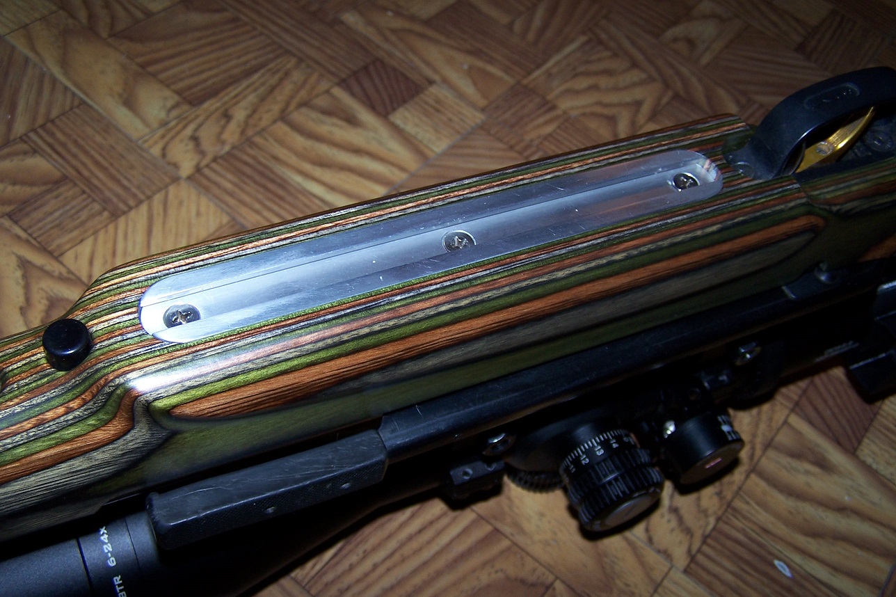

This is a good time prior to the 2019 FT season to be testing out physical changes to and new techniques relating to your spring gun and scope.
The Anschutz type rail will be very handy to easy application and removal of accessories such as the hamster.  I've often thought it would be nice to have one on my HW97, TX200 and other piston guns to add versatility like yours now has.
It will bring big peace of mind to minimize a loss of your QB58 while flying now that you can have it with you on the plane while traveling.  Shortening it was a good move and you have plenty of time to get the weight and balance figured out.
I really do think the hamster will prove to be helpful, especially if you need extra height on targets at a steep incline.  I have a similar RAM mount screwed onto the stock of my TX and I think it has been an advantage when shooting offhand and not just while seated.  Let us know how the extra weight of the C-channel and hamster help or hinder shooting in future matches.  I predict you'll find an increase in scores once you adapt to the new add-ons.  ;D

The QB58 shot OK at the last match with the RAM mount/riser attached but I did not actually use it as all targets were easily visible and no severe angles.
Today, I decided to actually try it in the backyard with different adjustment settings - not good!
The POI would shift significantly if the riser was lowered any significant amount. 1.5moa when lowered half way down. I had suspicions that there would be some difference but did not expect that much,
The mount works fine if you re-zero after each adjustment, but that defeats it's purpose for me. I'm going to have to rethink this. At this point I'm thinking of scrapping the Ram mount idea.

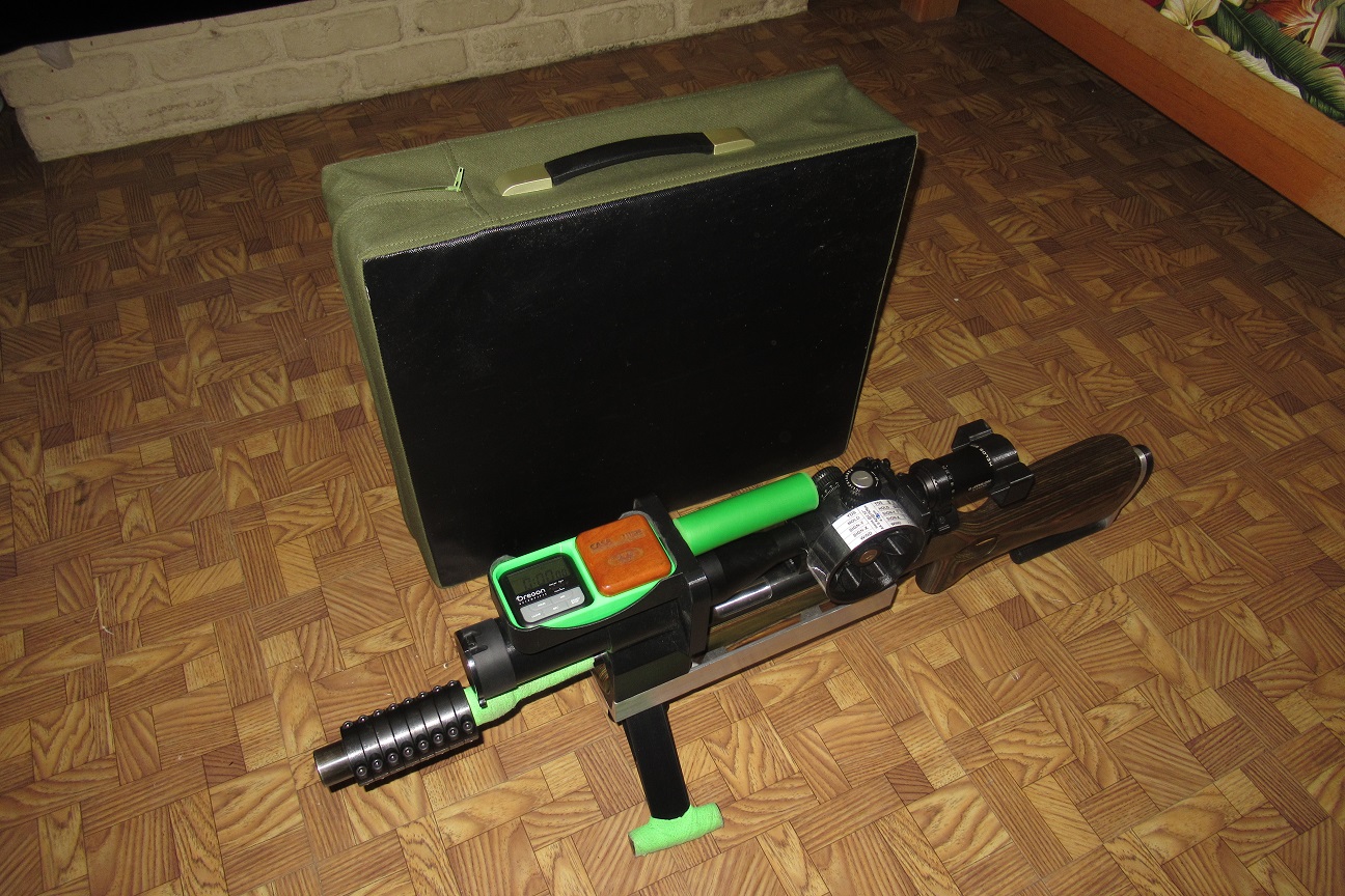

That seems really weird. Too much pendulum effect from the weight of that C-channel hanging down?
Not really weird.
I replaced the steel C-channel with aluminum so that center rail is about 1/3 the mass now. But I added a bunch more mass to the muzzle (clamp -on shaft collars) as that is where is seems to do the most good.
Any masses attached to the gun generate a force on the gun when the gun accelerates (recoils). If you move the point of contact, or amount of contacting force on a piston gun, the POI changes. That's why a consistent hold is needed - as the gun wants to pivot about any restriction to movement, whether it be an attached mass, your hand, bipod, rest, etc.
I've decided that any attached mass must be rigid and any changes to the configuration (hamster) during a match should not change the front/back and top/bottom CG location. So I made a light weight rotating stand/bipod/hamster.
I'm narrowing in on a configuration that I will stick with for several matches. I replaced the piston seal, breech seal and main spring. I'm shooting 8.44gr at 782fps or 792fps average depending on which chronograph I use. The total gun weight when shooting is about 17.5 lb.
I designed/built an integrated caddy with a carry handle. It has a tray to hold the pellets and timer while being carried. It also has an extra long sunshade built into it. I don't like seeing exposed muzzles being swung around, so I made a magnetic muzzle cap with a steel plate inside that should stop any accidental discharge, but it's real purpose is to act as a substitute for an empty chamber indicator.
