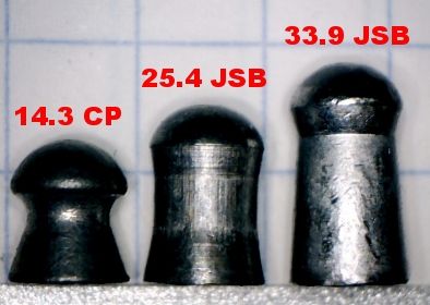

Main goal of this was at least a short comparsion of the 25.4gr. and the 33.9 gr .22 JSB pellets.
To get a sense of scale (photo on 1/4" graph paper):

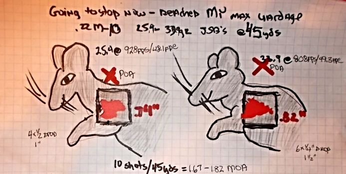

YEs, I did "waste" a few shot figuing hold over from the 25 yard zero to th 45 yard target. took me three or 4 "sight in" shots on a seperate target to figure out the hold to get "near center" on the hand drawn rats/small squirrels at 45yards with a 3-9X cope (cranked up to 9X).

Whole lot of information in the one picture above.
1. The 25.4gr. JSB is considerably faster than the 33.9gr. JSB, but for less energy per shot than the 33.9gr. JSB.
2. Even with the boost in energy from a better BC of the 34gr.pellet, it makes a "rat's arse" of differnce in accuracy.
3. In this limited test the 25.4's shoot better...that .08" difference is NOT ENOUGH to hang your hat on for just one 10 shot group.
4. Will mention, that with a 25 yard zero, the slower 34gr. JSB''d dropped about 1/3 more getting out to 45 yards (target is on 1/4" graph paper).

7. At least in this rifle, the .22 34gr. pellets work...but the 25.4's work better.
After considered debate..... For everyting I do with an airgun, I'd much rather have 25.4gr. starting at 928fps than 33.9g starting at 808 fps.
