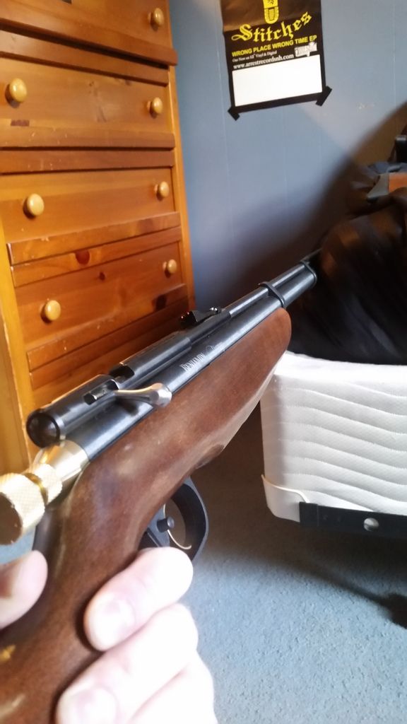

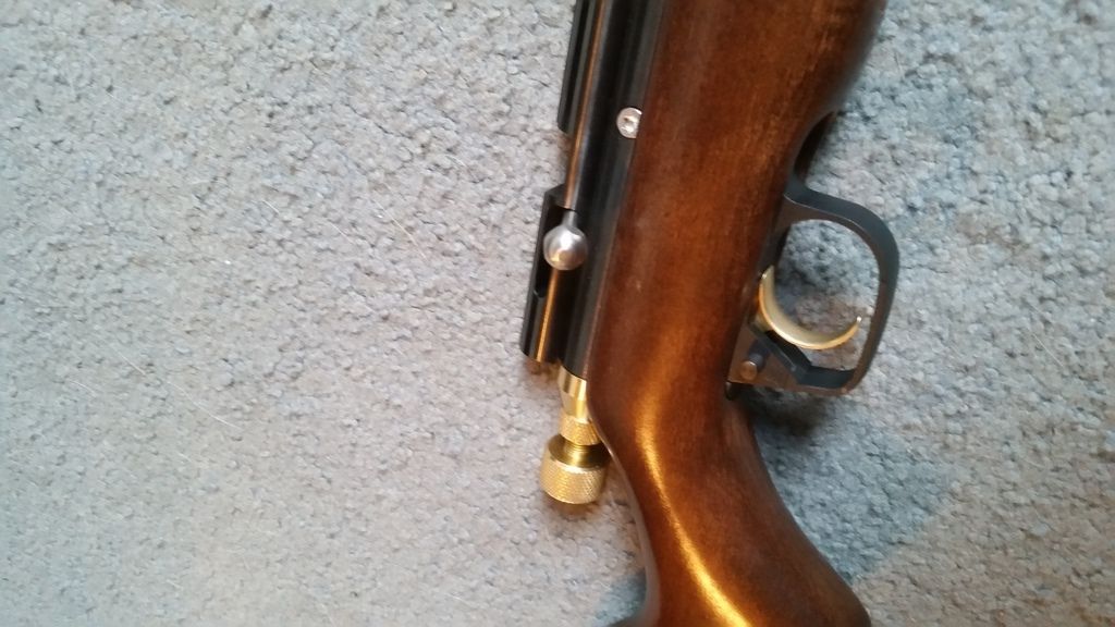

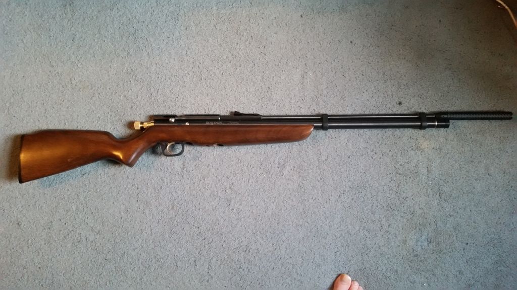

A while back I acquired an inline paintball regulator (air and CO2) with an eBay purchase. Been sitting on it thinking this would be a good chance to try regulating a CO2 tank. My main complaint with CO2 has been the varying POI due to temperature change. If I kept the regulated pressure relatively low (under 850 psi) wouldn't this allow for a huge number of consistent shots at a very wide range of temperatures?

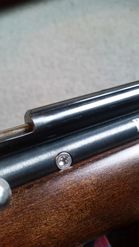

I'm in California.... About a hour or two south of Motorhead. Not quite the same temperature swings as you guys see in Canada. It'll all ice and stuff right now right?
"Cold" weather here is lows in the 30s and highs in the 60s. Summer highs go 100+ though.
I was actually thinking about 600 psi as you suggested Bob. With the HPA reg set at 550 PSI its shooting 14.3gr Crosman pellets at 430 FPS. This is a SSP250 with a modified breech and 18" barrel. No idea what work had been done to it, but it's interesting that in 177 it would shoot about the same speed as yours.
