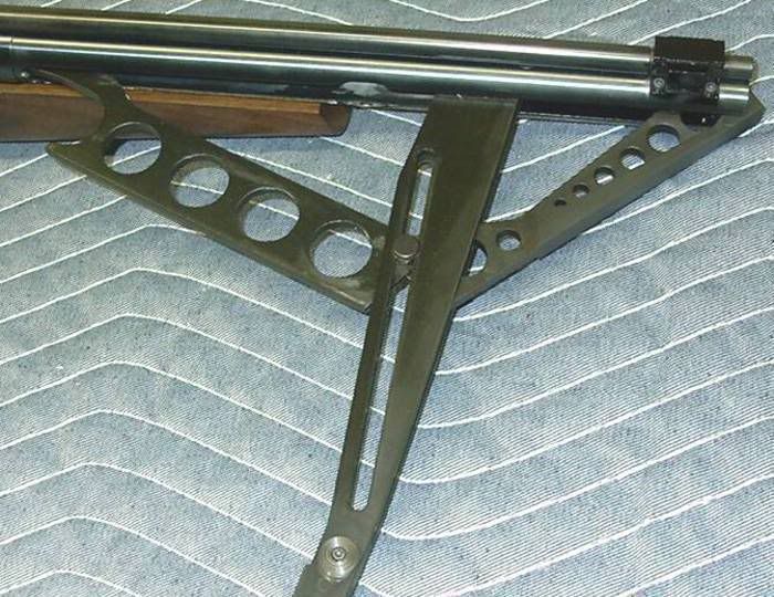

there were several 30 yrs ago pushing 12 fpe like the Bowkett.. What I noticed from this video is he has almost no mechanical advantage cocking the gun.. weird
Quote from: Rob M on December 16, 2016, 10:18:08 AMthere were several 30 yrs ago pushing 12 fpe like the Bowkett.. What I noticed from this video is he has almost no mechanical advantage cocking the gun.. weirdIt's sad they went away for whatever reason. That is a nice looking rifle! Do you know - did they fall out of favor because the manufacturers failed; because they had difficulties in their design; or because they were overrun in the market by more powerful rifles?
Rob, I'm well aware how pumpers work, and I know that the # of levers does not change the lever ratio. I misspoke when I stated that doubles the ratio. Most pumper designs cannot be executed with 2 levers. This opposed lever design cancels some of the reaction forces, increasing efficiency. Very clever. The vast majority of pumpers use linked levers to move a piston, and the mechanical advantage increases until the piston reaches the valve face before going over center. The basic leverage ratio is the applied force radius over the linkage radius. This is the ratio I was citing, which drives the rest of the math. Regardless of our spat, this is a really nice design. JMJ

I'm curious. Why the 1/8" gap between the piston, and valve face?? Wouldn't it be more efficient if there was no gap? You would have a higher working pressure if the gap was eliminated. Or, am I missing something?

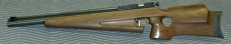

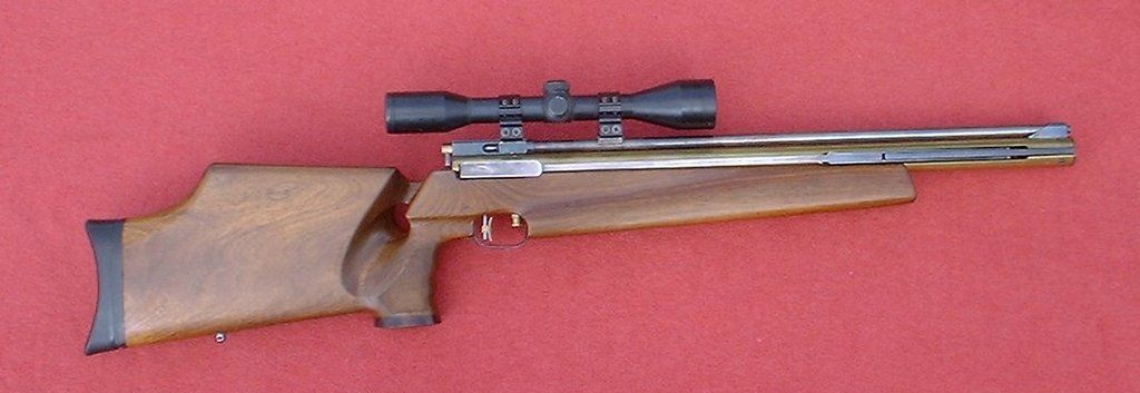

Made in Nova Scotia. SSP 22 cal shooting 700 FPS. Its very interesting airgun and wouldn't mind seeing it on the market. Watch the video.
