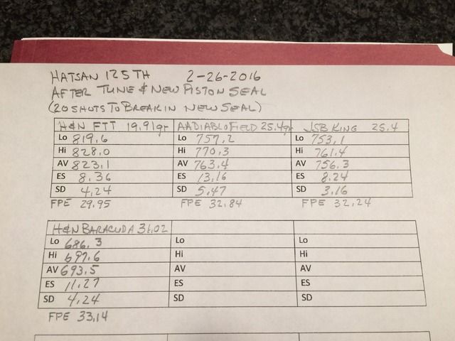

Quote from: Diced1 on February 25, 2016, 06:39:46 AMJoe, you made me actually sign up instead of just lurking . Sorry to see the piston seal issue, that's a bummer on a new gun. I just got a 125 synthetic springer on Monday in .25. My numbers are not too far off of yours. I cleaned the bbl with ballistol, pushed a pellet through it to check the rifling (will likely hand lap with JB paste over the weekend) and put about 30 shots across the chrony. I don't have my sheet but the Benjamin domes were high 600s, JSB Exacts around 715ish, and the H&N FTTs around 790-805. This was the first 30 shots...If those were in the order listed maybe it's the seal settling in or there was sparse lube and it is getting distributed? I'd try again with the Benjamin domes, if you still get 600's I'd suspect you got a oversized bore (and send it back for a replacement). You can push a pellet through to check also...
Quote from: Methuselah on February 25, 2016, 02:18:28 PMQuote from: Diced1 on February 25, 2016, 06:39:46 AMJoe, you made me actually sign up instead of just lurking . Sorry to see the piston seal issue, that's a bummer on a new gun. I just got a 125 synthetic springer on Monday in .25. My numbers are not too far off of yours. I cleaned the bbl with ballistol, pushed a pellet through it to check the rifling (will likely hand lap with JB paste over the weekend) and put about 30 shots across the chrony. I don't have my sheet but the Benjamin domes were high 600s, JSB Exacts around 715ish, and the H&N FTTs around 790-805. This was the first 30 shots...If those were in the order listed maybe it's the seal settling in or there was sparse lube and it is getting distributed? I'd try again with the Benjamin domes, if you still get 600's I'd suspect you got a oversized bore (and send it back for a replacement). You can push a pellet through to check also...Those were in order. The Benjamin domes are 27.8 grains (came free with my synrod) (JSBs 25.39, FTTs 19.) I did push a JSB exact 25.4 down the bbl with a Tipton .22 rod. There were slight marks on the pellet but it went through pretty easily, but I imagine the pellet skirt flares out from the heat and pressure to fully engage the rifling. I'll shoot it some more and see what happens. I thought the numbers weren't terrible compared to the guy with the posts of the various pellets (within 25fps). Do you mean the air chamber could be oversized? I don't really have a frame of reference on these guns. I would hate to have a good one in my hands and send it back to get one that's got issues. The real test will be accuracy when j can actually shoot groups instead of just into a trap in my garage.

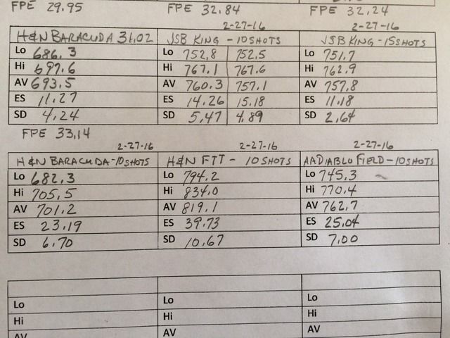

Wow Joe, ya done really good for a first timer by all accounts of seeing many many posts on first attempt tuning results!The numbers for extreme spread look great, the dieseling gone before round #10, I'm anxious to see some groups!!!On the search engine, someone suggested not too long ago to use Google (or was it yahoo) when a post is hard to find without advanced search functions. I believe it's now a sticky.Did you button, touch up the leade, re-crown, or change "the 3mm screw"?Again, really good numbers
