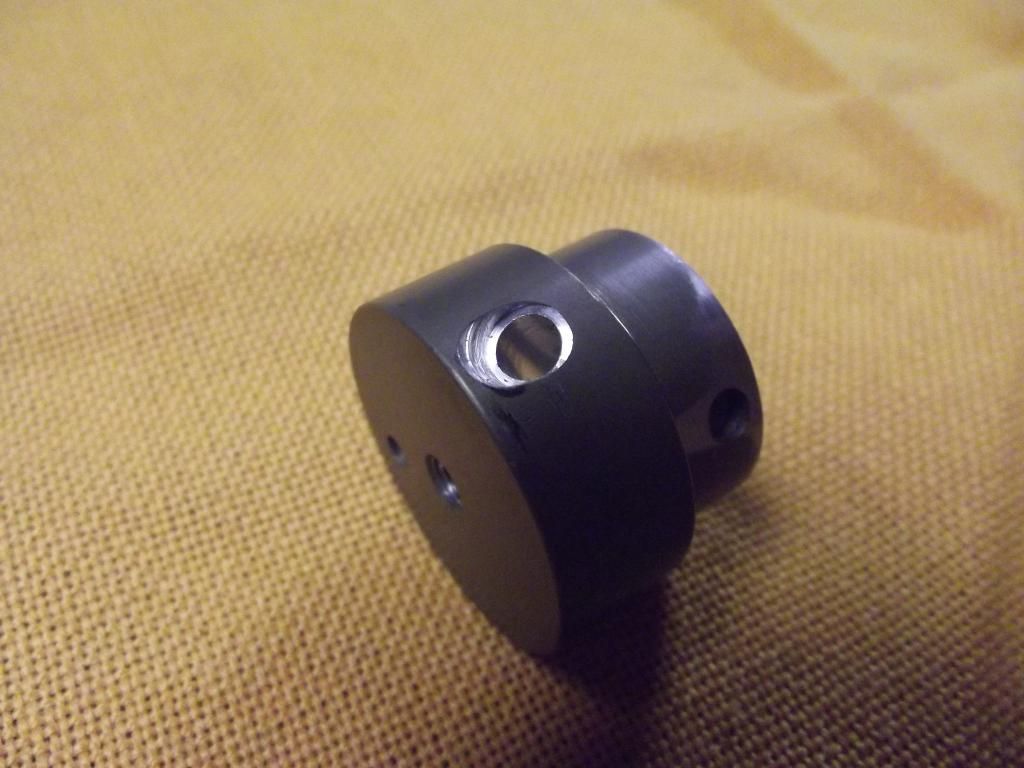

Thank Bob ...
What a B50 cap looks like vented ...
Hole is drilled on a slight angle to intersect the floor of spring cavity having placed a small pocket in the roof of the spring cavity. In this way the spring or any shims in place do not obstruct air coming in as hammer falls from the cocked position.
* Position of drilled hole found best ( As viewed from rear of action ) at @ 7 to 8 O'clock being along side trigger housing yet Under the stock getting covered up.
There is wood inletting clearance at that position within the stock and venting is hidden and free of garbage getting into the hole.
