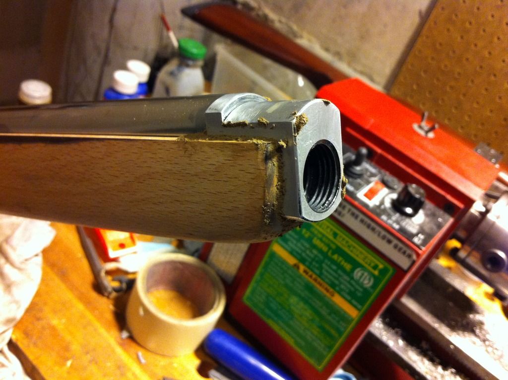

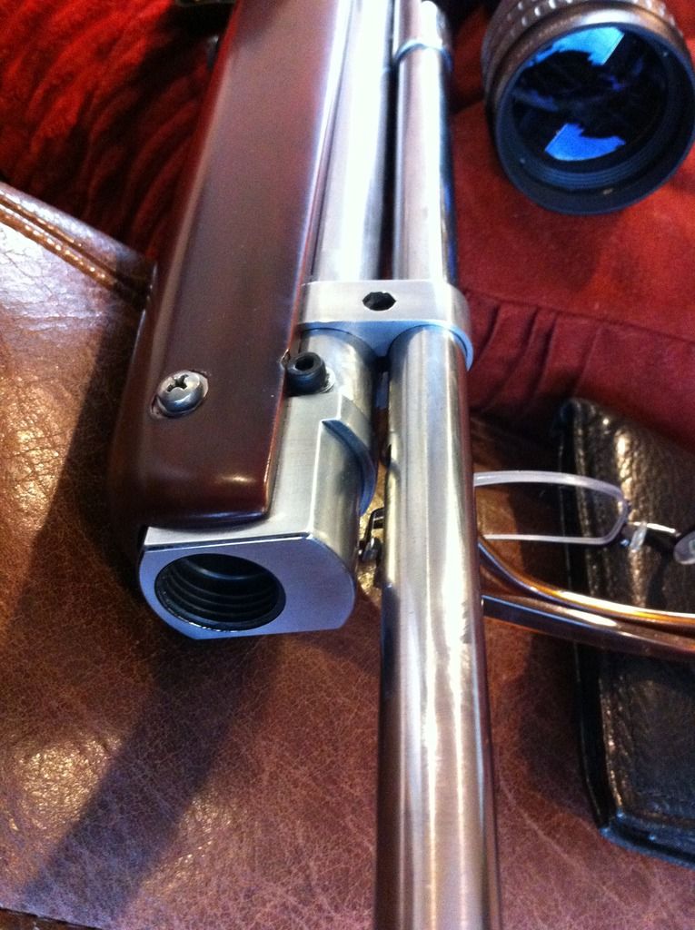

Hey mad87, make sure the burst disk is 1.8K.
Also, make sure your tank block is conservatively secured to the stock and air cylinder. Once this is done, you really
don't
want to be removing the tank from the gun unless necessary. I have used the Ninja 13 CI tank on my QB's.
I followed very good advice given here on the GTA and never had a hinting of a problem using HPA, however, we have seen some major accidents of late, by members and witnessed the
POWER
of HPA when handled carelessly.
Have fun with the QB78, this gun and the QB79 really bring back the KID in all of us and there very accurate to boot.

one burst disk is 1,8k and the other one is 5k.very nice qb79 you got
it gave me a good tip how to secure the tank block

That's a QB78D inletted for a QB79 tank block.
