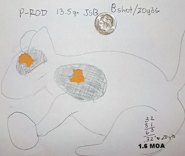

Was getting my P-Rod ready for a little “serious” squirrel hunting. Shot this at 20yards using 8-shot groups (the mag holds 8, so just used that number of shots per target).
No bench rest, just shooting off my hands rested on a saw horse (which is still more stable than most of the shots I get in the woods):
Really can’t directly compare 8-shot groups with 5-shot, so have to estimate. That’s about 1/3 larger than the best I can do at the same range for 5-shot groups, using a real bench, bags, and under calm conditions.

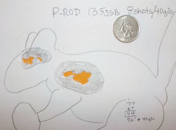

Checking the trajectory at 40 yards, found something odd (good-odd rather than bad-odd). The old Center Point 3-9X scope has “hash marks” rather than “dots”, and they aren’t spaced in true mils. Turns out, the 1st has mark is just about perfect for 40yards using this pellet and a scope mounting height of 1.45”.
Checking after the fact, found the spacing to be about 5.8-6MOA between hash marks. That works out to something like 2.3” at 40yards, which happens to be pretty close to the real world expected drop from a 20 yard zero.
Definitely getting a sideways spread as range increases. Going to have to call the “real world” usefulness at 40yards.

Looks good Ribbonstone;
My Prod loves the JSB 13.43 and dime groups out to 35 yrds, haven't shot it further yet. I also zero my Prod at 30 yards which seems to be best for me form 10 to 35 yards on a 1" kill zone.
Your sideways groups are still on the money for small game that's for sure.
