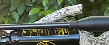

Did do the following:
1. Cut/crown the barrel to 16”. That RWS “compensator” doesn’t telescope over the barrel very far, so it looks longer.
2. Added a cheap 850PSI output 13CI tank.
3. Mounted an old Tasco 3-9X just because it was lonely and I wanted the 4X that was on it to use elsewhere. Did mount it as low as I could as the QB79 stock doesn’t have much of a cheek piece.
4. Changed the transfer port to a poly tube.
5. Valve is ALMOST as issued. Old valve still have that horrible little fiber filter/screen filter, which has shown itself to just disintegrate and foul the valve.
6. Adjusted spring tension (decrease) the old school way by removing it and cutting ½ coil at a time until I got down to 12-13 foot pounds.
7. 7. I got use to using the gauged brass on/off, but you can leave it off. Could cut the barrel back another 1.5-2” without it and make it even more “stumpy”.
So even set up for minimal air use, still see a little rise in energy for heavier pellets. Still in the 12-13 foot pound ball park, with the lightest (RWS Hobby) earning about 12.2 foot pounds and the heaviest tested (18.1gr) earning about 12.8 foot pounds.

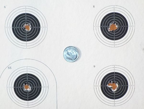

ACCURACY:
This won’t win any bench rest competitions, and perhaps shortening it to 16” actually helped it shoot well, but its “good ‘nuff”.
20 yards/ 5-shots each:
Do have enough airguns (more than enough if you ask my wife), so they kind of take on tasks. The task this one is best suited for is rat-zapping/suburban back yard pest defense. It’s short, really-really quiet (big LDC/ lower power/ small air use pretty much equals real quiet), accurate enough, and LESS likely to blow holes in my outbuildings (and if the rats are out in the shed or the shop, why would I want to shoot them?).

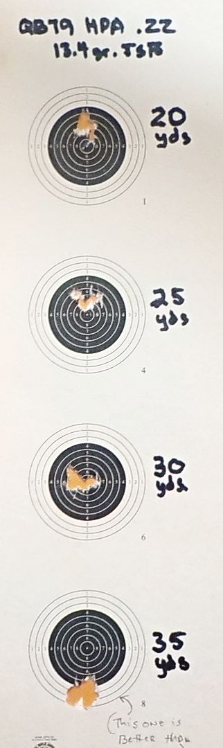

Not real sure I’d ever try shooting anything alive past 35yards…probably could get lucky at 40yards, but the trajectory makes things “iffy” much past 100 feet (which is why the title).
TRAJECTORY:
SERIOSULY…really expect a flat trajectory from 650fps/13.4gr.? Not going to happen. Wouldn’t happen with co2 as the gas, won’t happen just because air is the gas.
Can mitigate it a little, depending on scope mounting height, with the traditional 30 yard zero. That would put you about ½” high at 20yards and about 2/3” low at 35yards, which covers most suburban back yards just fine.
Something like 8.4-8.7 foot pounds left at this range, so I’d not try it on anything tougher than a small tree squirrel/rat.

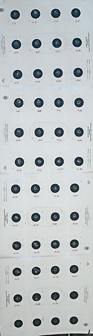

SHOT COUNT;
Does seem to take forever to both chronograph and shoot 43 5-shot groups.
Didn’t read a real drop in velocity until shot #206.
Velocity very uniform for unsorted pellets. Even the worst individual shots fell inside 2% (and out of 215 shots, have to expect a few odd-ball pellets).
So I’m not guessing/estimating/predicting +200 shots, have actually produced them.
