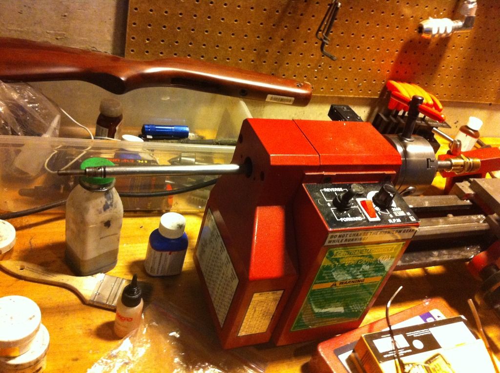

Re: Benjamin Pump Repair -> Problem !!
July 28, 2015, 10:30:14 PM »
OK, Got inner steel tube out, but it's still attached to the 25mm brass nut. Can't get at the #007 o-ring.
Put the smaller steel tube in the lathe chuck, clamped down very tight, still can't break loose the nut - must be corroded on. Now stripping steel tube with chuck jaws .......... WAPOS.
What kind of penetrating oil/solvent will work on a brass/steel connection?

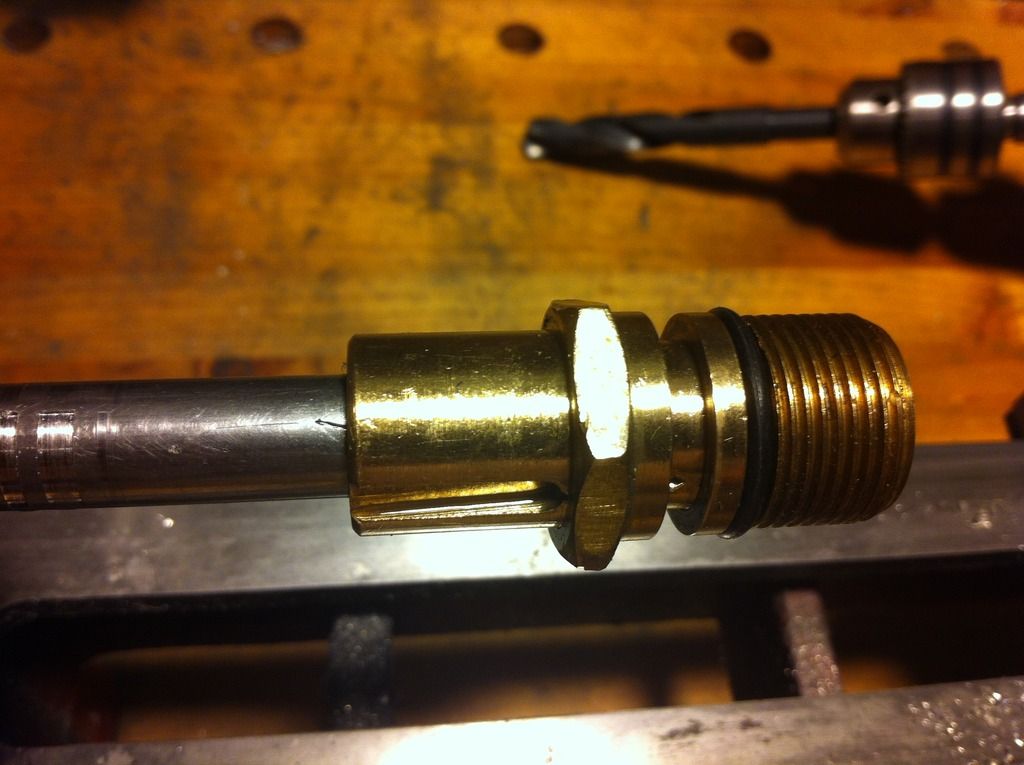

July 28, 2015, 11:05:00 PM »
Hey Guys,
As you can see, the steel inner tube came out of the end w/check valve. So still trying to get that brass bottom nut off so that I can get to the #007 o-ring. Need to break loose using some kind of solvent.

Got it
Because I can be pretty dense at times, I didn't realize that it just slides out the other end.
What a Bone Head

July 29, 2015, 02:37:38 PM »
Final solution
: Heat the brass end with a blow torch for about a minute. Because of the differences in thermal expansion between steel and brass, it came loose ...... slowly (it squeaked). The steel thread was rusted pretty good.
Melted a few o-rings in the process, but that's OK.
Kirk
