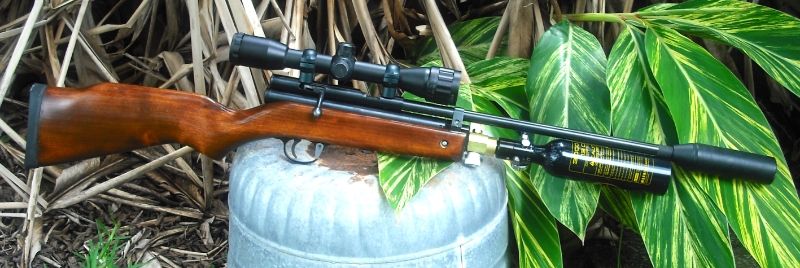

I have this awesome Beeman Super 12 (Theoben MK I) and it has a power adjuster that manages the power through hammer spring tension.
The gun itself
