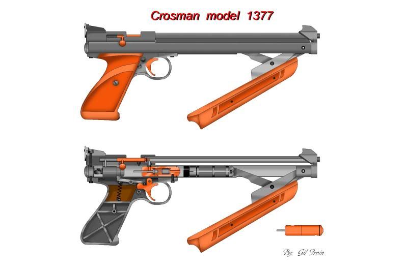

The flat top valve/piston set-up allows for more pumping i believe. you can begin to see what each part will do by looking at, and studying this photo. i have posted these before so you might have already seen them.
Daisy Powerline 15xt Pistol

Re: questions about power adjuster for 13xx,22xx series, etc,
January 24, 2011, 04:23:47 PM »
lighter valve spring on the 1377 just makes it eaiser to pump and eaiser for the striker hammer to release the air so u can pump it a few more times or alot if u get a heaiver striker hammer spring.thus increaseing the fps a bit.as the others said it is and will be an addiction if u like to shoot
