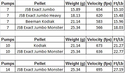

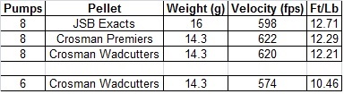

Hi David, I was hoping that other experienced guys would answer you. Seeing that you may be the only one that has a modded 2289 acp, you're the expert on that one now. You asked for ways to make it more consistent. More specific information is needed. It's cool that you get 3 shots, but you didn't mention on how many pumps. Also 3 shots at what fps/fpe & what pellet? Last, what more consistency are you looking for?
I am quite happy with my Crosman 2289g-ACP. It gives me 3 good shots with reasonable consistency, with just a tad of air left after the third shot.The trouble is that it is just REASONABLY consistent.I have no way to directly measure the AirPressure in the valve (I can only estimate by calculating), I have no good way to measure the strength of the springs, and I have given up attempting to measure the valve internal volume.I have increased the valve volume, verified that there is no issue with hammer bounce, tuned the springs as well as I can, did the standard valve porting, drilled barrel TP, poly tube TP, stuffed the piston, pinned the valve, pinned the check, took up the extra space between valve O-Ring and valve face, shimmed the piston, and made a cam over pop out pump handle pressure indicator.This 2289g does have an 18 inch barrel and a steel breach.MY QUESTION IS:What else can I do to improve the consistency of this 2289g-ACP?
