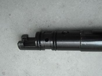

4. Pierceing cap leaked. Problem was traced to a bit of flasing on the seam of this plastic part, which wouldn’t let the end cap screw down far enough to cover the gas tube’s vent hole. Fixed that easy enough.

1. fixed the piercing end cap by removing the plastic flashing that kept if from sealing.
2. Plugged 2 of the 3 transfer port holes:

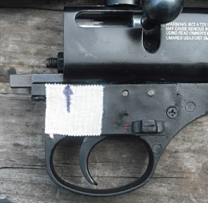

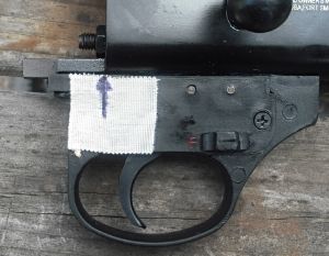

8. Adjusted the trigger location to the FRONT (to shorten striker stroke). It’s not much, something close to 1/8”.

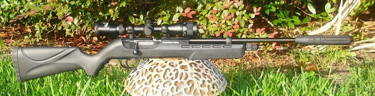

Ended up with an 8 foot pound (X 55 shot) co2 rifle that looks like this:
