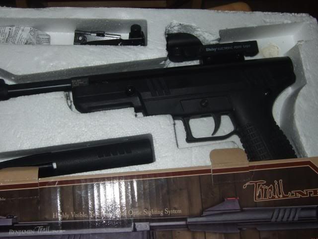

Just have to remove the scews and the factory sight comes right off.I put a Daisy electronic dot sight on mine no problem!
