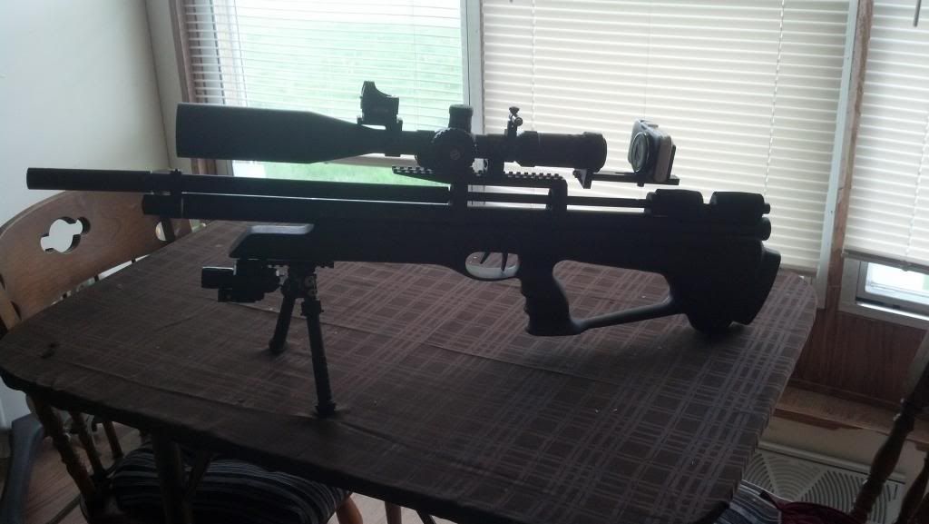

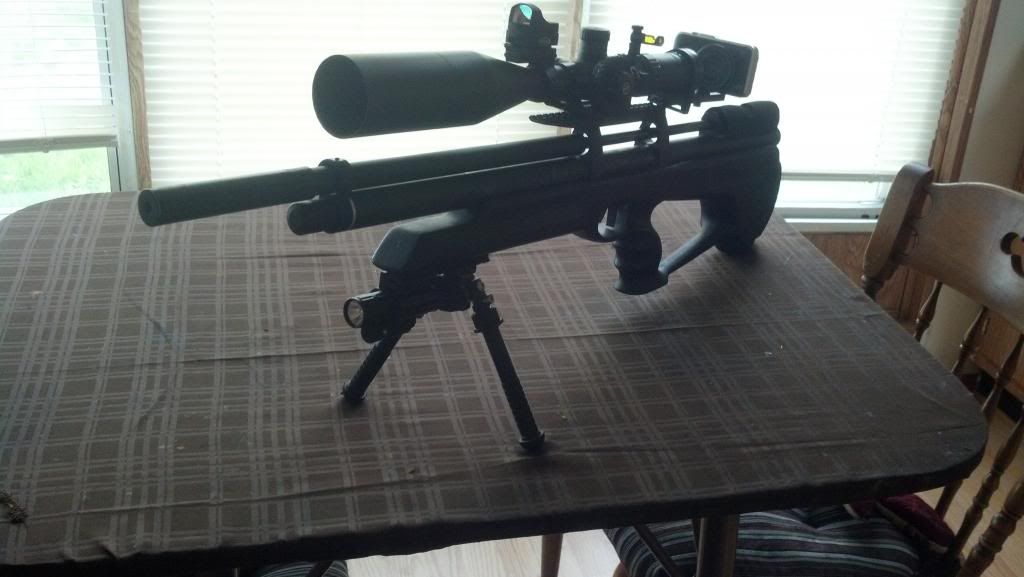

I am quite a ways from purchasing any higher end guns but have always loved the look of the Kaliberguns... anyway I reached out to my favorite machinist Mr.Gaska @ Marmot Militia and had him make me a shortened shroud and added his new SSBB..I also recently added two extra set screws to my shroud mount and am considering the extra barrel set screws and perhaps even the bedding but for now Im off to test tonight and hopefully do some varmint hunting if all works well. Anyway here is my Cricket look alike for now
Just checked my tune and shot 16 Kings between 919 fps and 929 fps
If i'm off sure isn't my tune! Cudas shot 16 between 869fps and 885 fps ..I was really pushing for the Cudas but the Kins are just plain precision maybe I need to do battle between the JSBs and my PolyMags as they are pretty neck and neck...soooo ready for the heavy JSBs !!!!!

I am on the same plan, I put the extra screws in my shroud mount too, and am also going to add the 4 more barrel screws as well. I have spent the last few days floating my air tube from the stock. I removed quite a bit of wood and finally add tiny shims under the trigger block to get the dollar bill clearance between the air tube and the stock. That really helped close up my groups, next, I am going to remove the o rings from the barrel band and go for the 3 set screws.... and on and on and on
