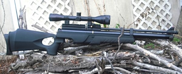

Did change to a more “heads up” scope mounting. Has that Weaver base, so may as well use it. Hunting gun, so a good part of my shooting will be offhand (or at least standing supported by the side of a tree), so the higher scope mount works well with that stance.

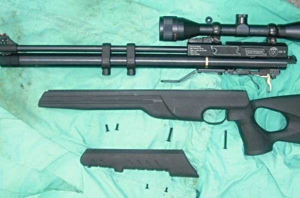

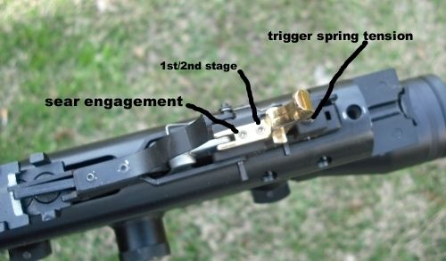

Now that the gun is wearing in, decided to go after the trigger before doing any accuracy testing. Adjusting the trigger before breaking the gun in a bit just leads to re-adjusting the trigger.
Can get to the 3 screws, awkwardly, through the trigger guard. But to really get at it to both adjust it and lube it (white lithium grease works) will need to do the following.
1. Flip the rifle “belly up”.
2. Take out the two screws from the pump fore end.
3. Slide the fore end off to the front (it rides in a dovetail).
4. Remove 4 screws: One for each barrel band and two for the action.
5. Stock lifts right off.
6. Trigger has 3 adjustment screws. Manual refers to them differently, but this is what they do:
7. Reassemble in reverse order.
BTW: Weird little lever inside the trigger guard is NOT A SAFETLY. When the gun is pump cycled, the pump locks forward. That little lever in the trigger guard lets you unlock the pump, so you can pump it back and remove the pellet cylinder. BEWARE: if the cylinder held pellets, there will still be a pellet in the barrel ready to go even if you do remove the magazine.
Trigger ended up as a “kinda” 2-stage, with the break taking about 1.8 pounds by my measure (trigger hanger and weights rather than a digital gauge).

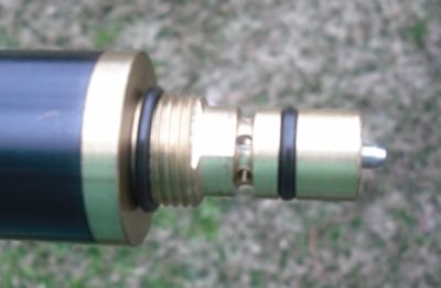

Start off with a safety concern for owners of older Hatsans.

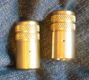

The brass thread protector for the older guns is a solid cylinder of brass. It screws onto the valve end of the cylinder to protect the threads when the cylinder is removed, and the cylinder is o-ringed.
Screwed on, the old thread protector is 0-ringed. So if the valve leaks, the thread protector contains the pressure. Which means, if it leaks, you either can’t get it off (as it’s holding 3K pressure inside) or you do get it off and have a nasty 3K surprise.
The new thread protector is vented between where the valve’s o-rings would seal. So if there is a leak, the leak just vents and doesn’t build up.
Old on right/new on left:
Also the new thread protector has an allen screw at the top. Idea is you can use this to degas the cylinder: back the allen screw up, screw on the thread protector, and screw the allen screw down until air hisses out the vent.
So if you have one of the old ones, do yourself a favor and DRILL IT FOR A VENT. If you are worried about dust getting in through the vent hole, seal it with wax (the wax will blow out of the hole at low pressure if there is a leak).

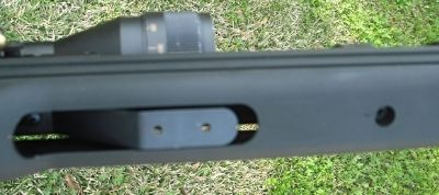

Also borrowed a modded Pneuma cylinder with 4 of the 6 valve ports plugged (leaving just the two aligned to the transfer port open).
As issued Cylinder with all 6 of the ports open:
Modded Pneuma cylinder with just two ports open:

Are you sure that the 4 port bloked valve is lining up with the transfer port ob this rifle. Im just thinking the reason they make them that way is so they do not have to be precise on there thread engagement.
Sweetwater, TN
Texan .45
TalonSS .25
2260 PCP converted
1322 supercharged
Re: Cheap Hatsan PCP (parts 2 and 3)..edit
February 22, 2014, 10:52:18 PM »
Actually, it ended up pretty much in the middle of the two open ports. Figured with two ports open, that would be the best choice.
Striker has more than enough travel to work, so if you ant to try one port, could shim the tube so that that one port lines up dead even with the transfer port in the receiver. Set up the .177 Pneuma that way for a time as a 12 foot pound gun with a whole lot of shots per fill.
Also filled in the groove over the plugged ports with epoxy putty, figuring having the air run around in a circle before finding its way up wasn't going to do any good.

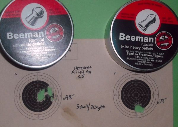

A little accuracy test teaser.

Anyway, here’s a quick 20 yard test of what I thought would be one of the worst and one of the best (just from the break in shooting/chronograph sessions). You’ll notice I’m still using up old stock.
