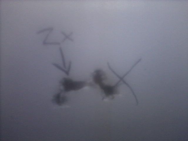

OK promise I'll get pics of the actual gun in a sec, but for now heres a few groups I got while zeroing the Chinese scope I fitted last night... What does anyone reckon to them? (Shot at 15-17ish yards unmeasured only paced out, knelt on one knee going off hand rested on the seat of one of my bikes, light breeze shooting JSB Exact Jumbo 15.89grain)
First group of 5, slightly low & the left one is a pulled shot
Second 5, pretty darn good IMO
Last 5, didn't take so much care with my aim this time as I was cold, first shot was pulled an inch left so I changed my POA to that hole for the rest of them, second shot went pretty much through the first hole
I don't think it's done bad at all, to be fair most of the variation is down to me! I've found all my .22s seem to just love the JSB pellets as far as accuracy goes, well worth the couple of quid extra per tin IMO

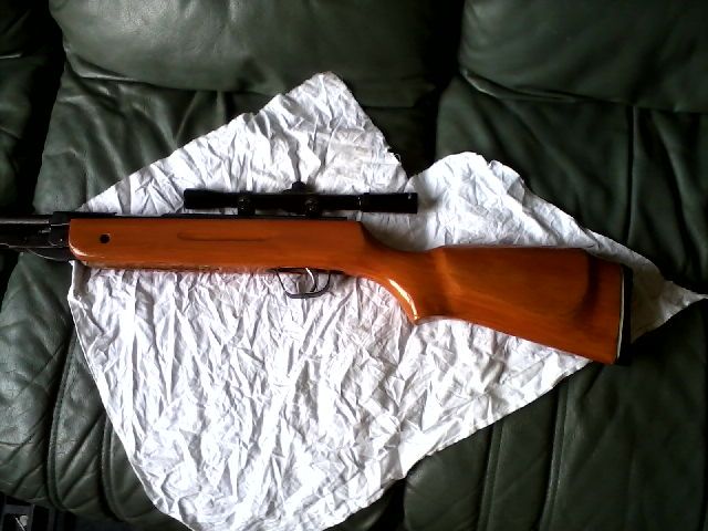

EDIT-: Here's the gun
Sat on sofa next to the .177 Meteor...

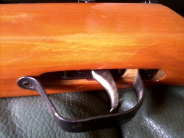

Metal 2-stage trigger & metal guard...

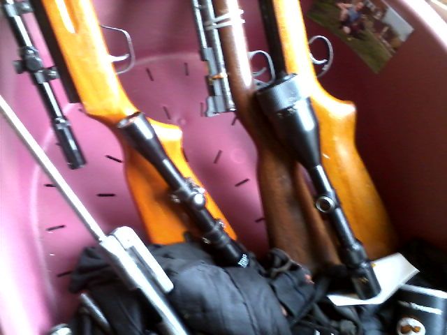

Some of the other guns, scopes and parts I have...

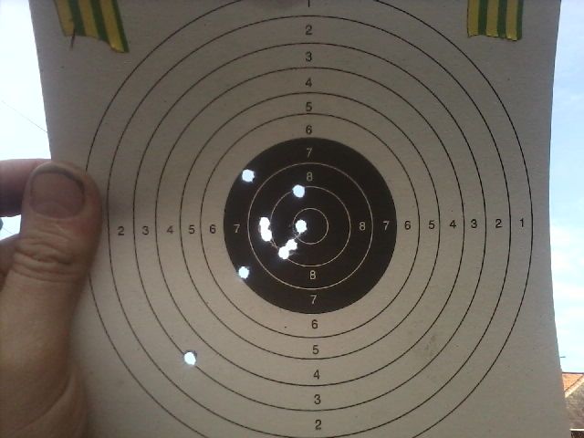

EDIT-: few more groups, same distance but wind starting to get a bit gusty now.
First target I did 5x groups of 5, couple of fliers...
Then I did a sequence of 10 shots on this target, standing offhand. Don't think me & the gun did bad at all considering the wind. The 3-pointer was my fault
