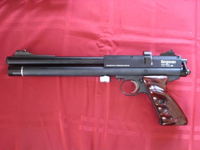

Well the ramp + sight was way too high!
In fact, the ramp by itself was a little too high. While I know what to get now, took the file to the ramp to make a sight out of it. Also, because it is mounted to shroud, I can't epoxy like RS did. ie need to rotate shroud to get it off. His shroud extended past the end of the airtube. Need to drill and tap two screw holes into shroud, but need to be careful to exactly where they go.
Ray,
I think that long fiber optic would need to be 1/4" - 3/8" above the shroud. The sights have to be a little higher than normal to clear the mag. The WGRS-54 comes with a peep sight, but I changed to blade, but can easily switched back. It took a bit of filing, but the WGRS-54 fits now. When I'm done, will post some more pics.

I had to wait and get a #6-48 tap for the front sight screws. While I couldn't come up with a both sights in focus photo, it does clear the mag. Range tested it to 35yds today. Fresh snow helps in that matter.
