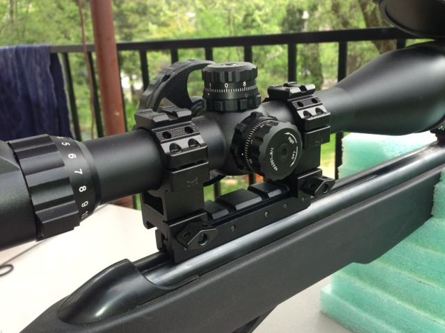

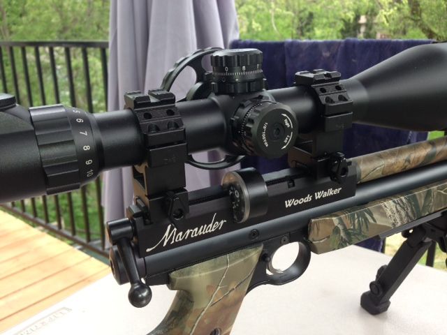

IMHO carrying an air rifle with a scope rings mounted handle is not a good idea. This would add undue stress to the 11mm dove tail rail, rings/scope, effecting overall accuracy. The 11mm dovetail rail is not designed for a carry system.But I do have a solution! http://swfa.com/NcStar-Other-Scope-Mount-P49635.aspx . These mount to your 1 inch scope tube and u could clamp in a 1'' wood dowel , or aluminum, for a carry handle, with notch for turret clearance if needed.Another solution, use picatinny/weaver scope rings with caps http://swfa.com/Burris-Xtreme-Tactical-Picatinny-Style-Ring-Tops-C652.aspx http://www.weaver-mounts.com/rings_bases/tactical/picatinny_ring_cap/ that have picatinny rails on top of 'em! Mount another set of extra high scope rings on the cap picatinny rails and clamp a 1'' or 30mm dowel into the top scope rings as a carry handle, notched for the elevation turret clearance, if needed.!
that would be handy for benji/sheridan pump folks .
Quote from: D14Jeff on May 08, 2013, 08:07:02 PMthat would be handy for benji/sheridan pump folks . the detachanle carry handle for ar15 flat top would go right onto the integrabase..... the only thing you would need to do is cut a loading port in the carry handle..sorry, i am having a problem with the system and am unable to do caps, most punctuation, or symbols... greg
