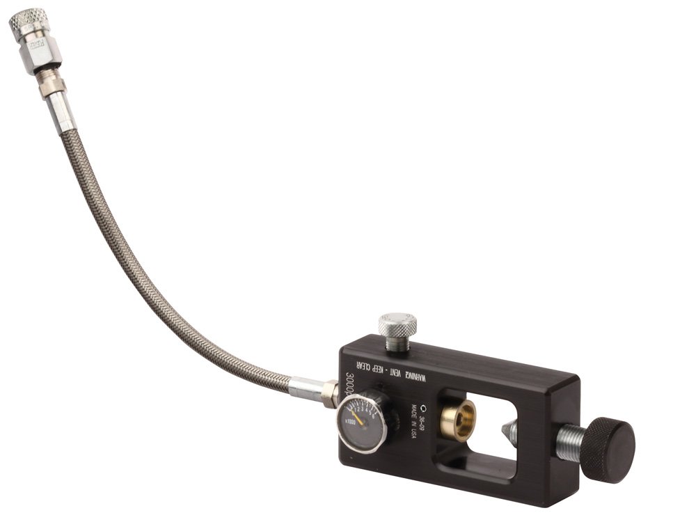

This all started because I wanted a more accurate gauge on my disco. Well I found out that there was not real good solution that.
So I decided instead to put a nice guide on my fill assembly. I started looking for gauges. I found that very few that had 1/8 threads and the ones I found were more money that I wanted to spend. So I decided to go with 1/4 threads and an adapter.
I went to northern tool and found this. (the guauge is not the correct on the picture)
http://www.northerntool.com/shop/tools/product_357743_357743
The went to McMaster and got the 1/4 to 1/8 NPT adapter
http://www.mcmaster.com/#catalog/119/19/=mkdbo4
Now I get accurate fill read outs. I listen to the click for my low point and then stop for the high.
My assembly started like this.
Now

Yup, Those nice larger face glycerin filled gauges are the go too for sure !

You can also get a 1.5" glycerin filled gauge with 1/8" NPT threads, so no reason for an adapter....

I saw them. But I wanted the big dial.
