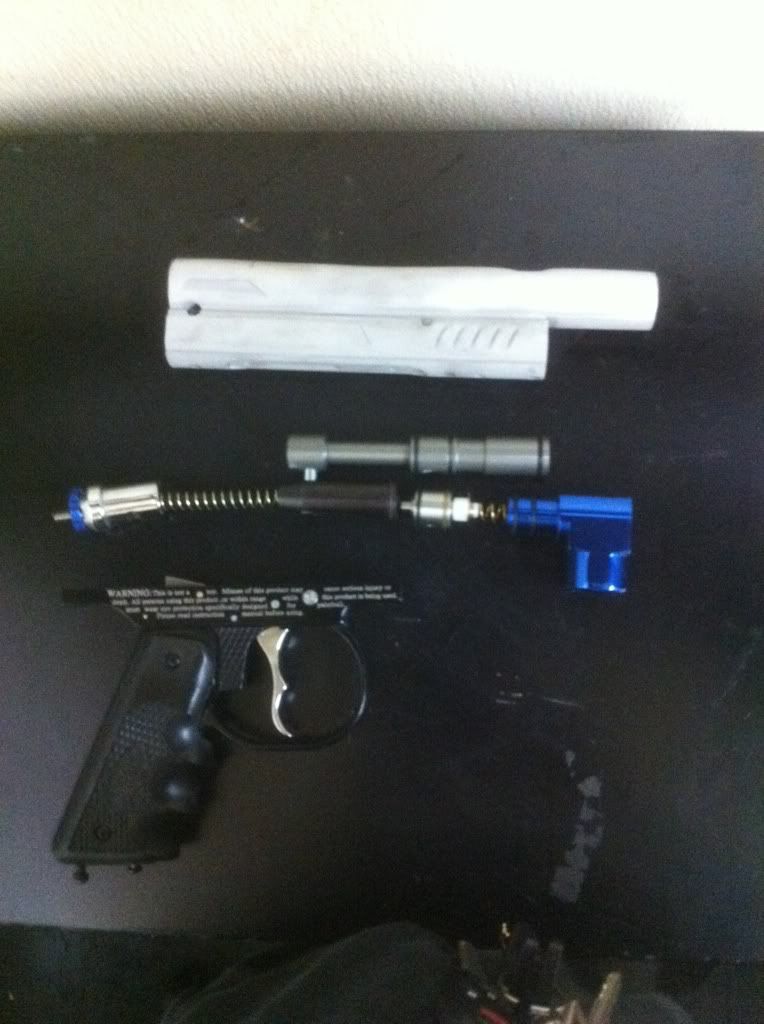

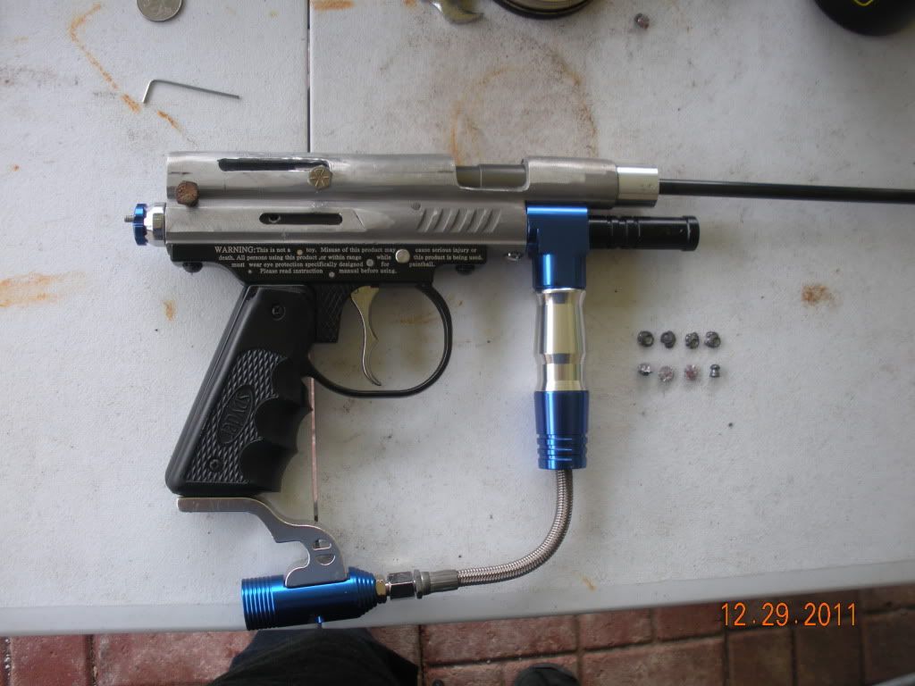

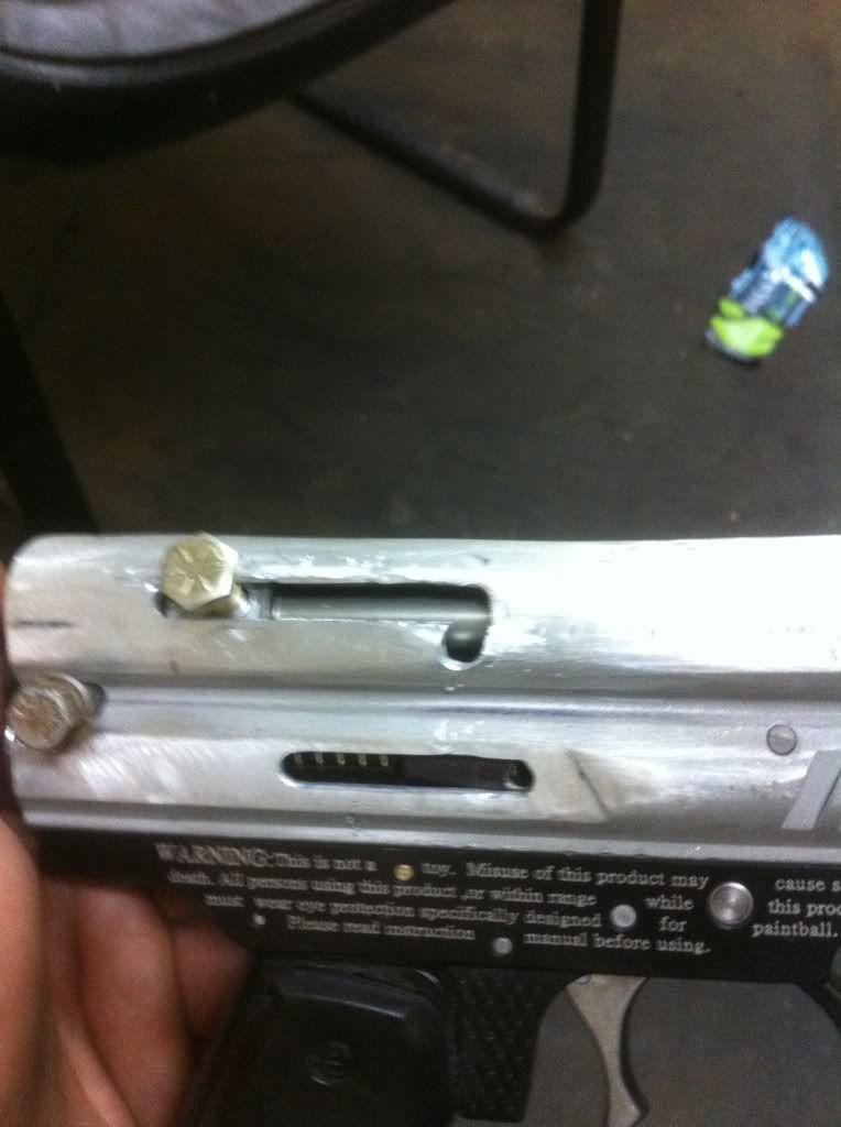

last year i started this project,worked on it for a few days,relized i was missing the expansion tube,and my tank was empty.
all this work is crudely done with a drill,bits,files,hack saw.
just wanted to see if it worked out before polishing a $)((#!
i put it aside and forgot about it,till a recent thread brought my memory up to speed.
so i threw it back together and fired about 100 rounds sofar.
i just chronnied her at 2 passes
high 464
low of 458
thats a solid 6 fpe running on all stock valves,ill have to see about modding the internals.
my goal is 600 fps on the low end.
she auto cocks,but have to load and seat the pellets manually to shoot.
parts used!
-older model spyder(the one with the oring sealed anti chop bolt)
-hammerli x2/mendoza rm2006 .22 cal barrel
i had all this lying around doing nothing.works better than i expected.
no sights but seems to be fairly accurate.
i shot a soda can at 35 yards.
heres some pics and a vid!

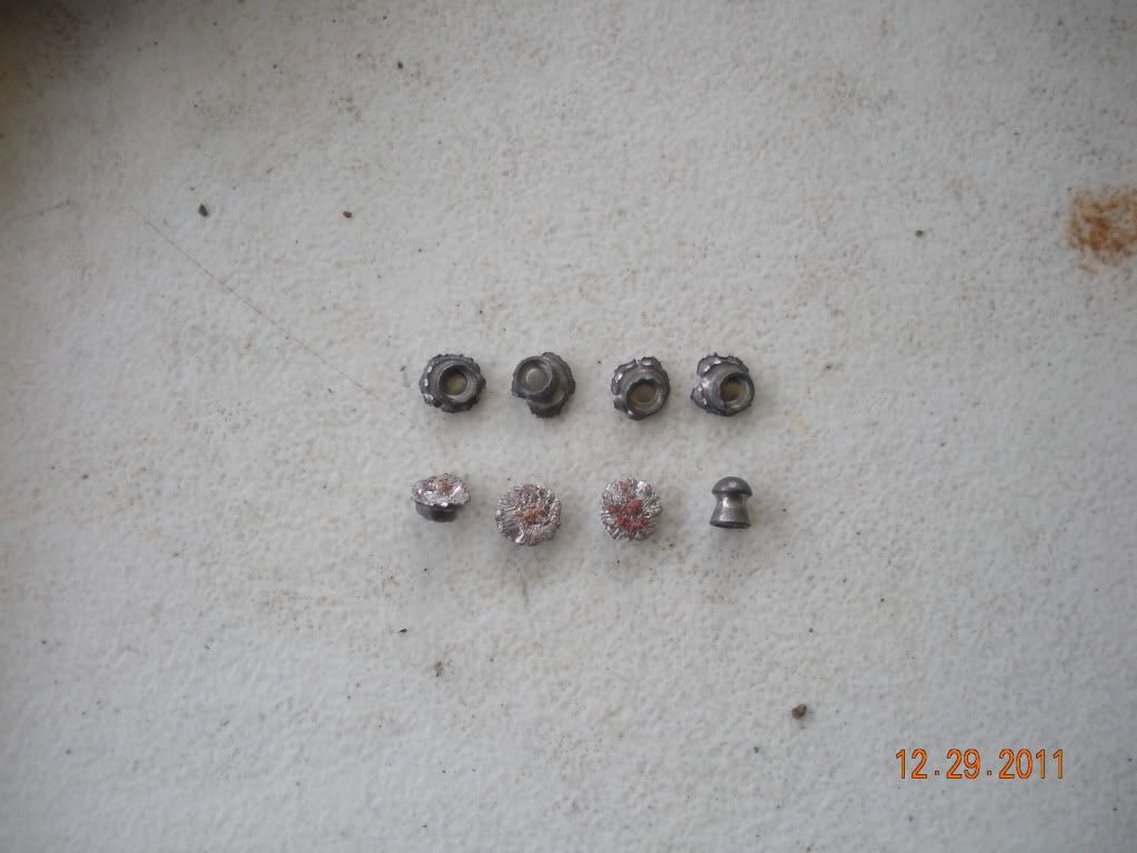

these pellets are cphp's fired at a brick backstop at 10 yards.

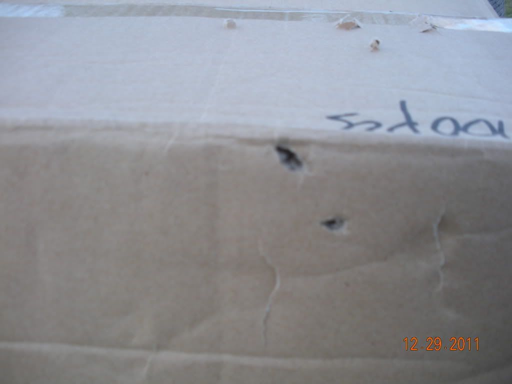

after 200 rounds my 20 oz tank feels about 3/4 full...still heavy.
heres a 5 shot group,4 in 1 hole,1 stray!
maybe it was just luck....but im liking my luck sofar!
its very difficult to aim this awkward peice in the same place twice.

I plan on pulling the bolt apart, there is a divider that bolts in there, ill make a new divider with a probe, instsall bigger orings to help seal her up better.
Everytime i shoot i feel a blast of air in the face,
Im sure it equals a fps loss.
Will move the barrel back aswell.
