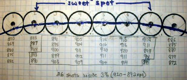

Guess the easiest way to check the number of "good" shots without a chronograph would be to set a target out at your normal max. range for practice and shoot. Keep track of each pellet's hit, and once it starts consistently hitting low, call it the end of the "good" shots. May find that your point of impact climbs a bit at first as well. Aren't talking a lot of shift at short range.
Will find a picture.
OK..different gun...and i do have a chronograph....but shot this row of targets as i was getting velocity readings. Can see how it started a little slow, leveled off to a "sweet spot", and then declined in velocity. Pellet impact wasn't a whole lot changed, but enough to measure.

Ahh, gotcha... I'll get a bench and try that ...so far I put it on a tripod and a towel to shoot, my hand shakes a bit a each different shot so no accurate measurements thus far. Thanks for your input, i will shoot again tomorrow and post results.

Can print free graph paper from on-line sites, which makes it easier to keep track. Some guns do tend to wander their point of impact a bit, which complicates matters a bit.
One way to look at shot count is to think in terms of the target you are shooting...if plinking bottle caps 20 yards, then could keep on shooting until the rifle showed 1/2 a bottle cap of drop (which would be a lot of shots).
