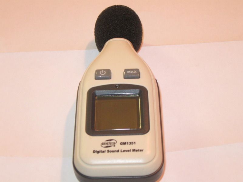

I recently purchased a cheap decible meter, and was wondering if there is a easy way to tell if it is reading accurately ?
here is a pic of the one I got off of ebay for under $20,
I'd like to know how accurate it is, so that I can compare it to my other AG's.

The most definitive way would be to send it off to a calibration lab. Too many variables to account for otherwise.

I tried a cheap meter for recording airgun shots and it wouldn't even give consistent readings on one gun at one distance.... so I returned it.... I believe the "samplng rate" was too low, so it wasn't always recording the sound of the shot....

There are several apps for the iPhone available for free. You could get a couple of them and just compare the results. Short of having your device custom calibrated, this will give you some indication of how accurate your meter is.

A problem is some/most are probably designed for a constant level of sound.
The single instantaneous sound of a gun shot may not be properly handled by those meters.
It is similar to the old peak vs. averaging VU meters on tape decks/recorders back in the 70s. With an averaging meter, you did not see some of the audio peaks that would be distorted in the recording.

Here are some data.
Key Features
Highlights
This unit was designed according to following standards:
A. International electrician committee standard: IEC PUB 651 TYPE2
B. US national standard: ANSI S1.4 TYPE2
Measuring range: 30~130 dBA
Accuracy: ±1.5 dB
Digit & Resolution: 5digits & 0.1 dB
Frequency response: 31.5Hz ~8.5KHz
Sampling rate: 2times/second
Microphone: 1/2 inch polarization capacitance microphone
Max HOLD
Low battery indication
Auto backlight display
http://www.lightinthebox.com/digital-sound-level-meter-gm1351_p301897.html

With a sample rate of 2 Hz, that meter is dead in the water for what you want to do with it. Would be good for constant sounds, but not a shot from a gun.

To capture the impulse of a rifle or airgun, it needs to sample closer to 30-40ms and have a frequency response of upwards of 20Khz, because it's the high frequency sounds that damage your hearing the most.
